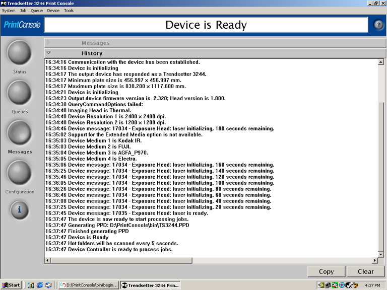

Mohamed if thats the size it sends you then you wont be able to use the plate size you want it might be configured like that from factory i know it can be changed from hyperteminal or serviceshell but if you dont have exprerience in changing values on the serviceshell or hyperterminal then just dont do it you might damage your ctp, i can help you doing it remotly send me a pm so we can get on with it.
Dear All,
Thanks for your help.
Dear Carloss,
Thanks for you help.
Are you seen the below massage?
and seen the machine software?
What`s your recommend for me ?
It seems that your machine is the "E" type. With the firmware version >2.32b (2.40b and up) minimum plate size restriction is removed. Your current revision is 2.32 ("b").
So I recommend firmware upgrade.
Regards

I have trendsetter 3244 CTP machine and i had problem with it.
i can`t install a minimum size for it 3943x330 mm, the last size can be installed 525x459 mm.
I need help for this case.
