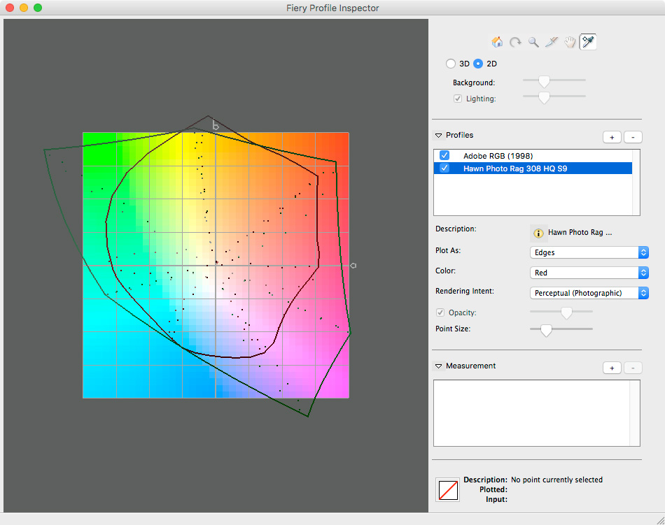

What is the output device. You can proof your photo in Photoshop using the output device paper profile.
Here is the gamut difference Hahnemule 308 and Adobe RGB on a Canon iPF8400. Large area is Adobe RGB.

Thanks Michael. Is it a gamut question ? My printer accepts Adobe 1998 and I soft proof and adjust to stay in gamut. So an image captured in a camera with a wider DR is going to be shifted around and compressed into another colour space, then printed onto a paper with a reduced ability to produce the full range of the original capture. If the original capture records a greater DR on one sensor over another, I'm thinking that this DR advantage is going to be effectively lost when the image's colour space is re-mapped using whatever rendering intent I choose and then printed. Am I on the right lines ?
