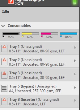

Also in machine status the machine recognized the Tray 6 and 7 but in command workstation i can't see any idea

Also go to your printer settings for the J75 and make sure that tray 6&7 are selected as installed options. I see you have trays 5 and 8 installed but 6&7 are not listed so you won't be able to pull from them using the Fiery but the engine will pull from them when copying.
Sometimes your PC or Fiery can "forget" what options are installed. This, or something close to it, is the solution.

I tried everything but again i cant print from Try 6 and 7, but when i do photocopy from machine its working not from PC or workstation

Okay, it’s a good thing that you can copy using trays 6&7 at least you know they’re functional. Make sure that you have the latest versions of CW and also the latest printer driver for the J75.
When you look at your printer driver for the J75 do you see all the options that are in the image below? You should see Tray 6 and 7 (oversized) as an installed option. If not, then select it from the available options and add it. Then select update to make the changes on the Fiery driver. I don't have a J75 driver but you should see something very similar.
