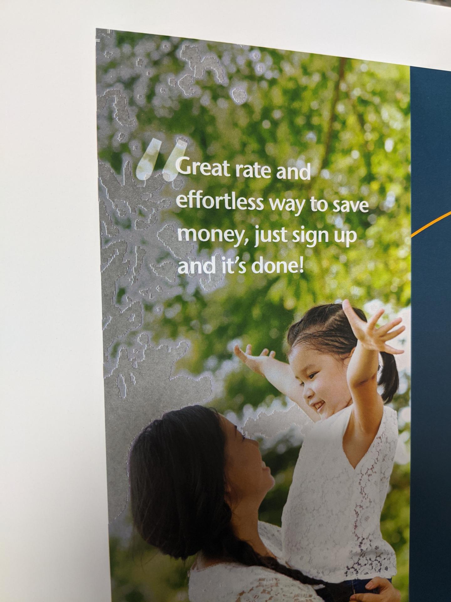

I have this job that has us scratching our heads here. Customer supplied pdf looks great on screen but when printed on our Cannon Image Press 810 there is a weird choppiness in a background gradient. Anyone ever dealt with something like this before. Picture attached

Are you talking about the silver spots that kinda look like embossing? Could be your fuser belt is dirty or one of the rollers is dirty causing deletions in toner when going through.

forgot to mention that I sent the file to another printer we do business with and he had the same issue.
keith1
You should post the original PDF file. Let's start by examining that. What it looks like on screen doesn't matter.

PrintingFools
I would have the same question. Am I able to review the file. I could probably fix whatever the issue is and send the file back to you. Then I would be able to explain what it took to fix the file. Happy Help, B
gregbatch
It's a transparency issue. Probably a rgb photo over a cmyk background. Save a copy, convert all to cmyk and flatten it.
namelessentity
Printed fine on my Imagepress750... I would guess it's what gregbatch said. Usually I see stuff like this when I use a hotfolder, but it goes away when I print with the print driver instead.
Magnus59
The Device-N shading was causing your problem. It works perfectly after Normalising with Prinergy without flattening. The Device-N shading converts to a process colour shading
gregbatch
gregbatch you nailed it. Converted everything to CMYK and flattened it. Looks awesome!! Thank you everyone for your input!
