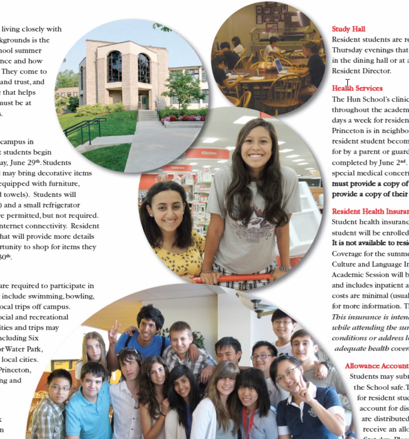

Yes I did export with native transparency. Like I said the PDF looks fine out of Quark, it's after trapping and ripping the problem shows up. If I place the bad PDF in InDesign and PDF it traps and rips perfect.
Would you be willing to post a PDF of the page you shared earlier? I'd like to run it through my rip and see what I get. I am merely curious because I've processed many a Quark job with Quark-generated drop shadows and haven't seen this issue.
Hi almaink, I've seen the same thing once before, very similar content; drop shadows on circles that overlap, default Prinergy Trapping was my cause, turned off the Trap part of the Refine and everything was fine.
Thanks Glenn I use Rampage though and there is no refine. Not trapping the page was not an option either.

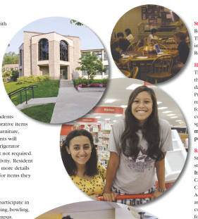

This is what I got with an Apogee rip using standard settings the first time out. Seems to be ok:
So it's the PDF trap engine then, figures. We are running version 12.1 of Rampage. I didn't try the old method because of the live transparency and time was an issue. Odd how refrying it through InDesign fixed whatever caused the problem.
Not refrying as such, just reserving - refrying is generally understood to mean going to PS and Distilling, not just wrapping the PDF in a new PDF skin.
EDIT: Screenshot of a default 1st Refine/Normalise/Trap process from Kodak Prinergy Powerpack attached, no issues visible (APPE RIP).
