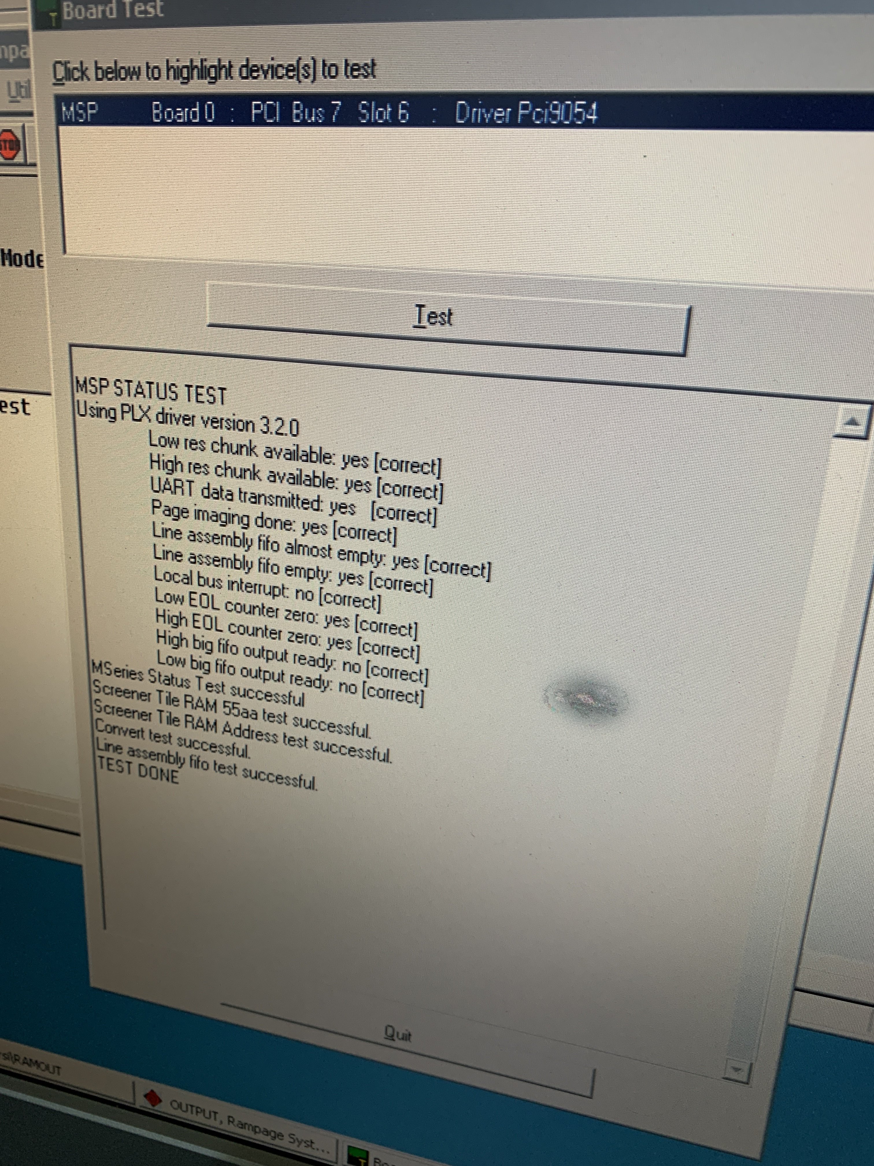

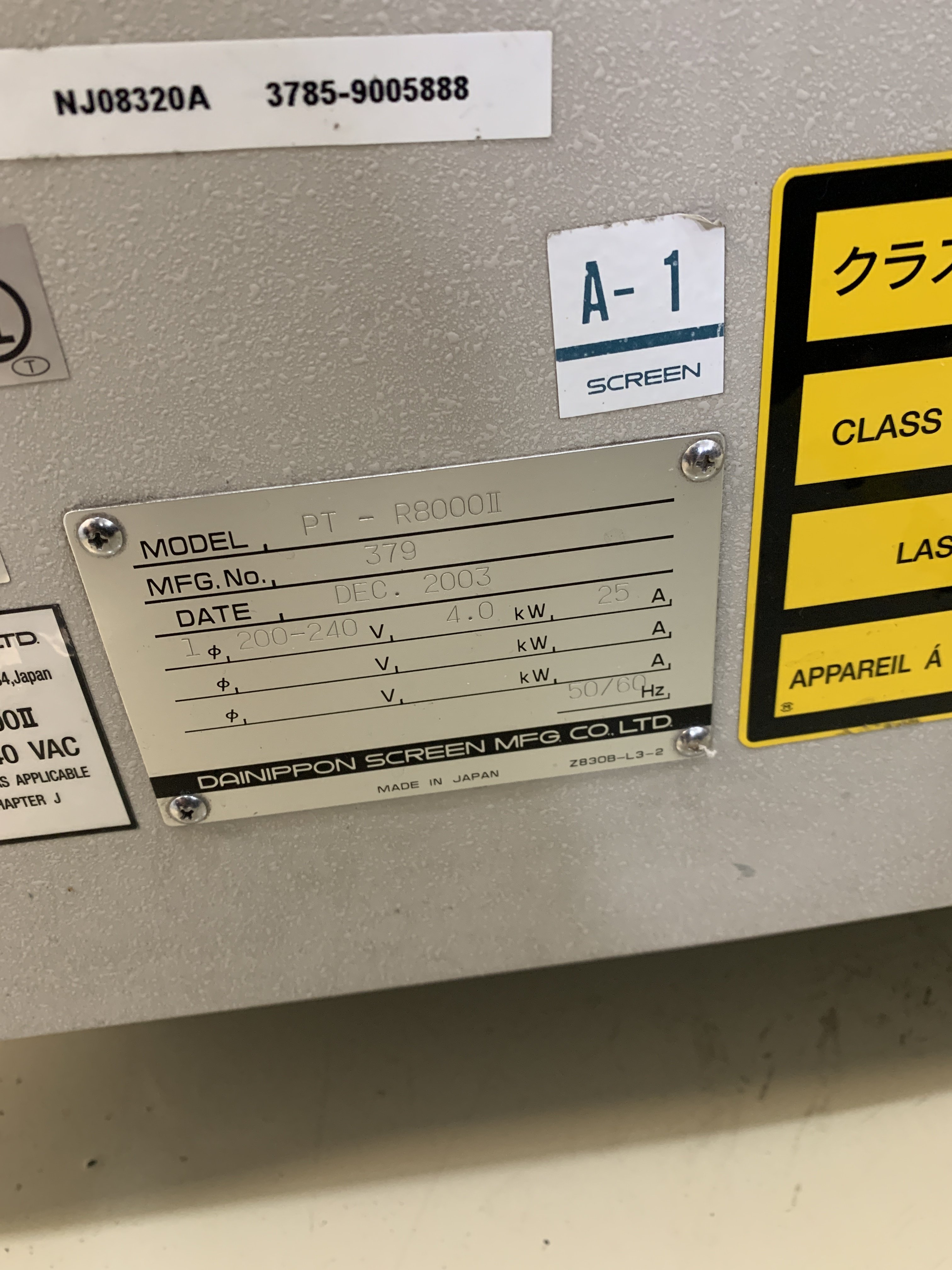

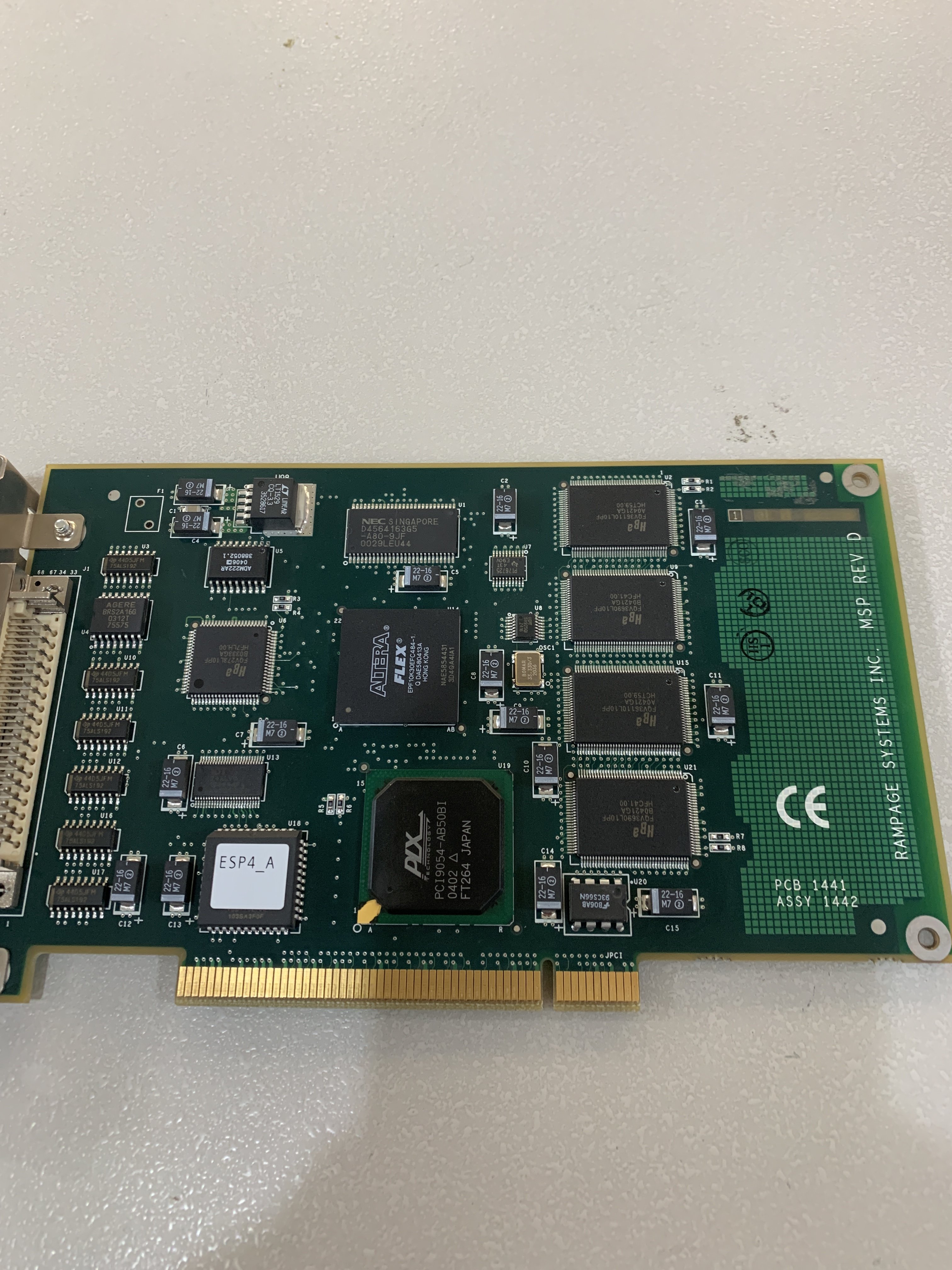

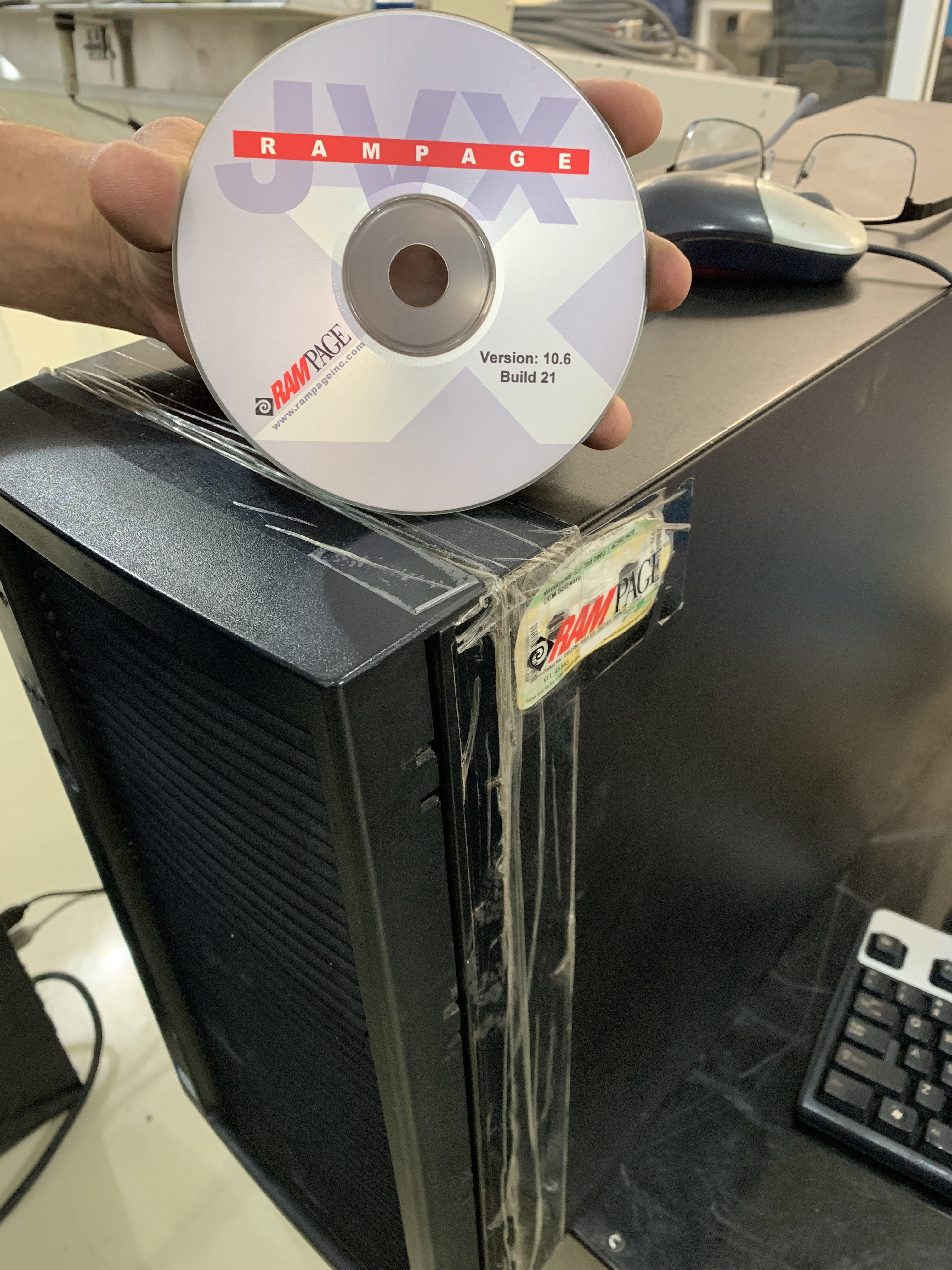

I am looking for help to load a Rampage Systems RIP Version 10.7, these are the tools that have my customer:
Server: Intel
OS: Windows Server 2003
RIP: Rampage Systems V 10.7
Output device: Screen PT-R8000II (labeled to Fuji: Luxel T-9000 CTP II) manufactured year 2003
Driver: PCI Board from Rampage Systems
My main problem is that I do not see the CTP on the Rampage software, so is imposible to get communication between them.
Thanks I appreciate your help.

I can't remember exactly where but you have to add a device separately and I think it's with a standalone program, like a utility. Start by looking in the folder made by the installation.
