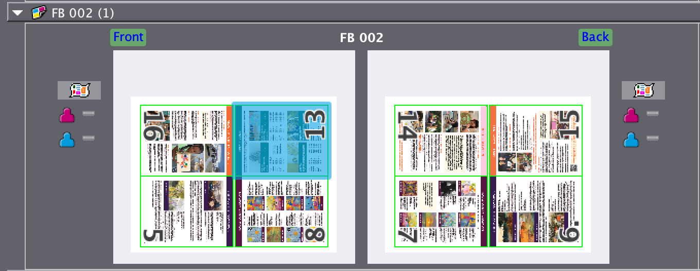

Hi,
After re-installiing cockpit on an iMac I lost the ability to preview just one page. For instance, in the picture attached I used to be able to double click, say... page 13 and a PDF would open to page 13, now it opens the PDF at page 1.
Anyone know how to change the settings?

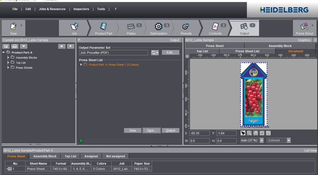

Yes, Ashok is right . The option to view a single page is available in the signa.
