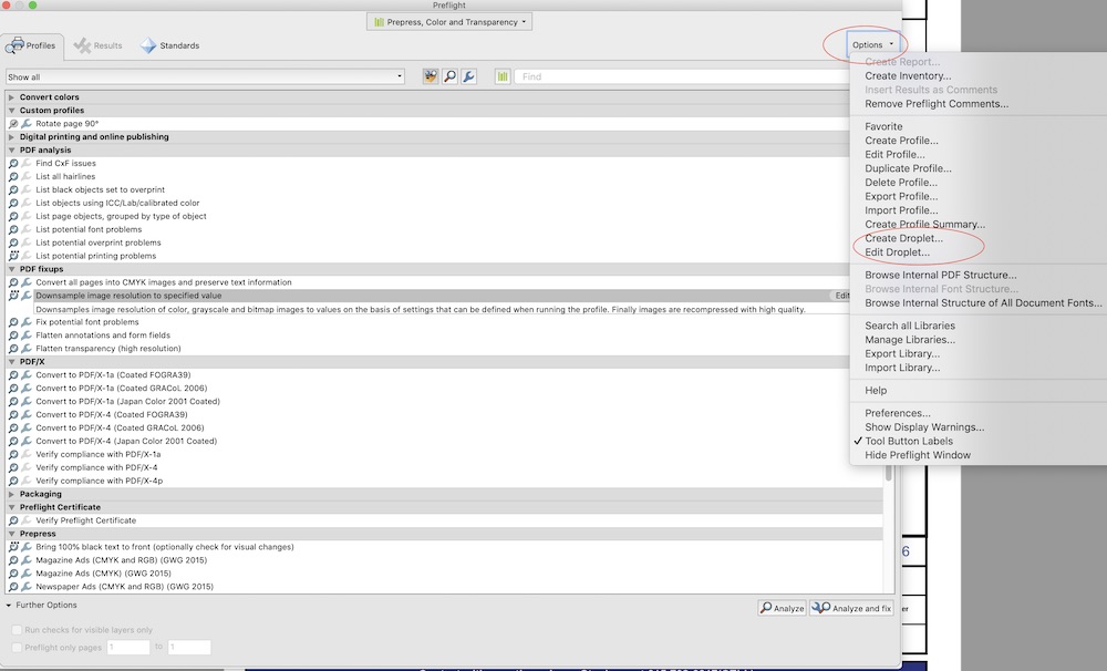

Separately, for the droplets, i can't figure out how to select my custom fixups to create a droplet - i don't see them on the list.
Joe
You select the fixup and then in the upper right corner of the window click options and then select Create Droplet.

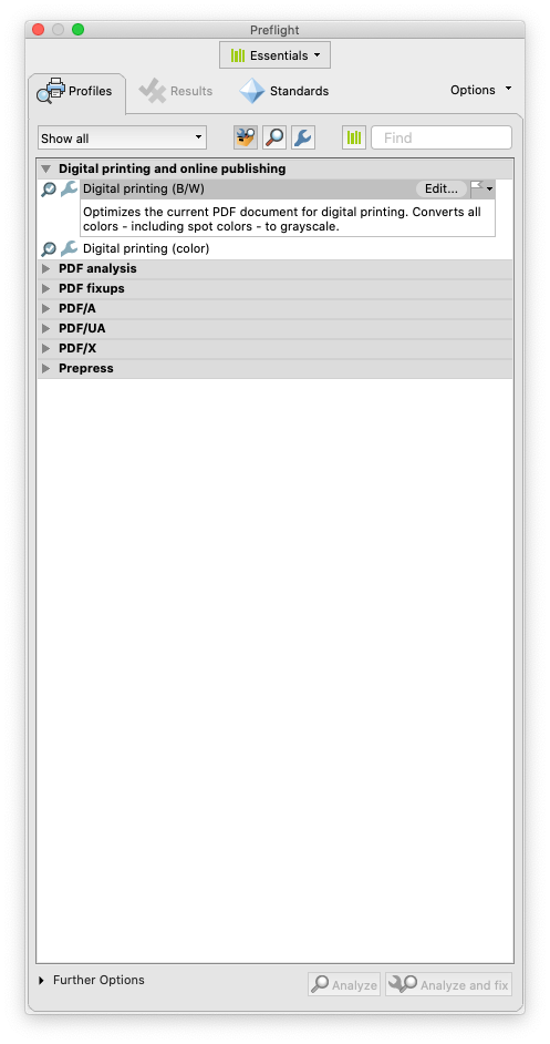

One other trick is that the preflight panel supports multiple libraries. You can find them at the top of the preflight profile window. You can click that window and make a new - empty library.
Using "Manage libraries" (same menu), you can then copy only the profiles, checks or fixups you are interested in into this new library. Much cleaner environment.
