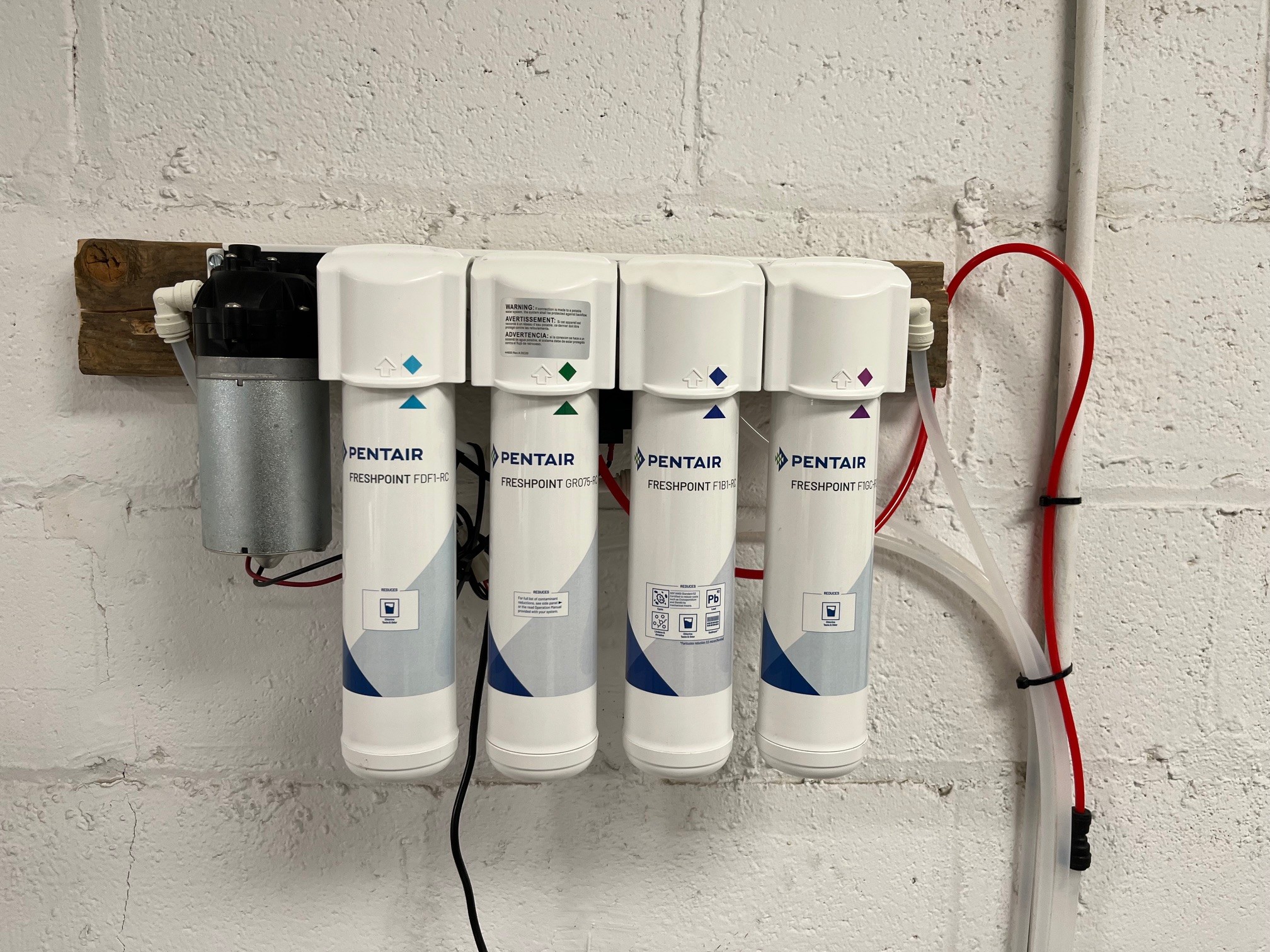

Just last week I had this reverse osmosis system installed. It's rated to produce 90+ gallons of purified (not sure if that's the correct word) water per day. I used an inexpensive total dissolved solids test meter and saw that the reading went from 120 at the municipal tap, down to 7 on the finished side of the filters. This feeds my ultrasonic humidifier directly by hose. This way I do not have to fill the humidifier and I'm going as far as I can reasonably go to keep the mineral deposits from finding their way onto surfaces that might have a problem with it. It's taken a few days for the humidity to get from 15% to 35% in my 4000 sq ft somewhat open room, and I'm running it 24/7. Next I'll be replacing the ceramic discs in the humidifier that vibrate to create the mist as I think they're not putting out as much of a cloud as they did when new.

I had RO at home and hated how much water it wasted with backflushing, l would be curious to know how that unit does.

The waste water is unfortunate, but I gotta do what I gotta do. My system doesn't get backwashed, it just generates waste water at about a 50% clip. My understanding is that water softeners need to be backflushed/backwashed.
