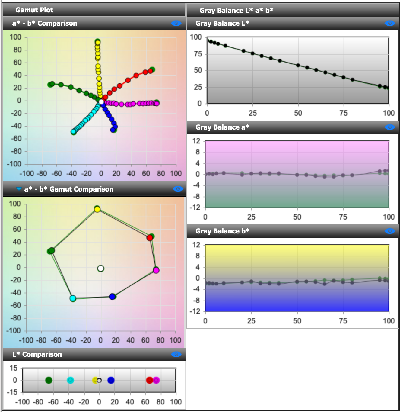

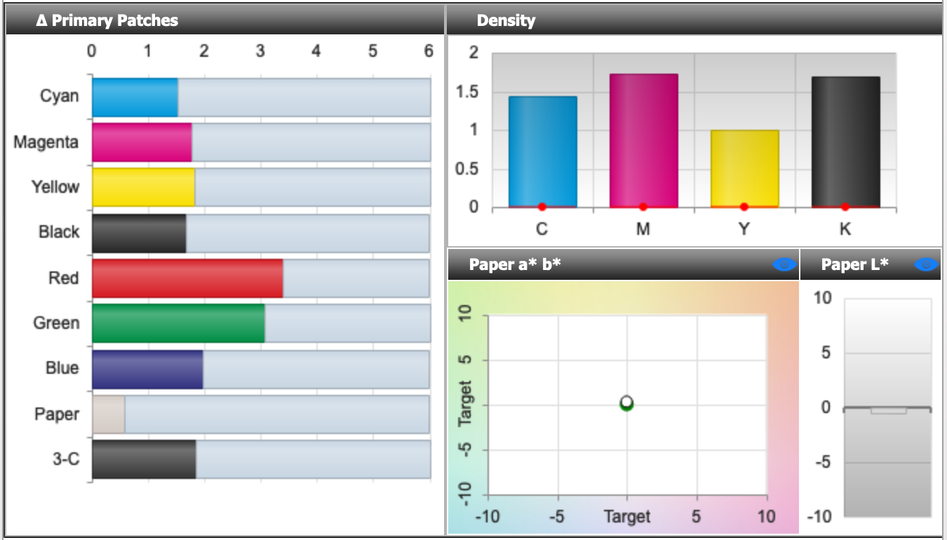

Bypassing the SetGold completely and letting i1Profiler manage linearization, ink limiting and curves within the ICC profile worked beautifully. I was able to have a G7 compliant proof using the TC1617 chart within about 30 minutes. I ran the first calibration chart with no color management at all, read that into i1Profiler with the i1isis 2, took the generated ICC profile, and installed that in Navigator and printed the TC1617 test chart. See screen shots.
It's not perfect, but the little bit that the grey balance a* and b* are off wasn't worth pulling an adjustment.
The biggest thing was to bypass SetGold and let the i1Profiler software do it's thing. Apparently, trying to use SetGold in the middle was conflicting with the adjustments Profiler was trying to make and just making a general mess of things.

The only other slightly off part of the profile is the density of the Magenta. For some reason it's reading the density at 1.80, but the L*a*b* of it is almost perfect. I chose to ignore the density in favor of the passing L*a*b* since density is really more of a reference point.
Not as detailed as I get for profiling the press, but are you looking for an actual print comparison like the old ship images, or what the test chart patches are reading as?
In the first screenshot the bottom bar of the left hand graph is the deltaE for the CMY average.

The dE results that you show there are not too bad at all. I agree that the dE is more relevant than the density reading. Seems a bit strange that it should be so high though.
@Quicko58 My license is a carryover from a really old ColorPath Verified license, so that's probably where the weirdness comes from.
I agree on the Magenta density being so weird, but the press matched the proof exactly. Even to the browns and such, so I'm just going to go with it for now.
