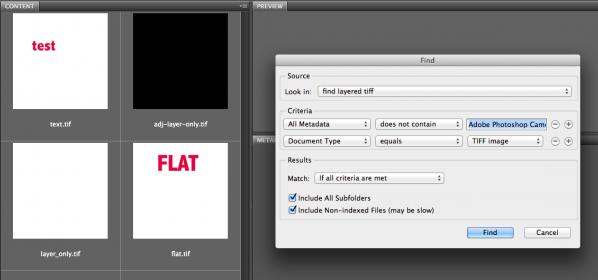

After exhaustive testing (i.e. not exhaustive), I worked out how to do this using Adobe Bridge using a generic keyword (layer/Layer/LAYER) using find all metadata.
EDIT: This only appears to work for text layers, not pixel or adjustment layers. Sigh… Still trying to find the XMP metadata that is different between a flat and layered TIFF.
Stephen Marsh
Tested in CS6. A study group of >1 is preferred to verify findings.This is not a definitive finding, it was just the first thing I found that worked! :]
Gregg, can you please test and confirm if the following works for you? I would also appreciate it if others could test and confirm if the following isolates layered from non layered TIFF files in Adobe Bridge.
It appears that a FLAT TIFF contains the following XMP metadata that is not present in layered TIFF files. The content highlighted in bold red would appear to be useful for a keyword search using Adobe Bridge’s Find command (All Metadata):
<stEvt:instanceID>xmp.iid:F87F1174072068118083984FF3A5DF29</stEvt:instanceID>
and
<stEvt:softwareAgent>Adobe Photoshop Camera Raw 9.1</stEvt:softwareAgent>
Before and After screenshots excluding the keyword “Adobe Photoshop Camera Raw”:
EDIT: With further testing I found a number of false positives returned when searching for TIFF files that were created outside of Photoshop and or had XMP metadata removed. So this is not a foolproof method of finding layered TIFF files as it relies on Photoshop XMP data being present. However it may just work for Gregg in the context of this particular workflow.
EDIT 2: It appears that this also returns false positives with CS2 flat TIFFs, so again if the metadata does not contain the appropriate keyword the filtering fails.

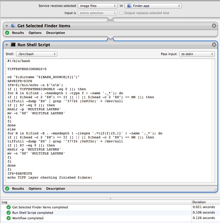

I tried setting up the shell script inside Apple Automator as a service, so that one could select the files or folder and right click/services to access the shell script anywhere in the finder.
Still trying to figure out why it will not run as a contextual service (or application)…

Anybody know where I am going wrong? I have tried different variations…
