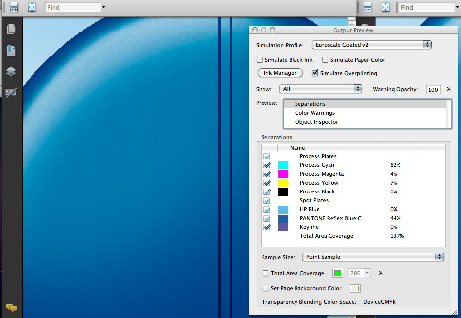

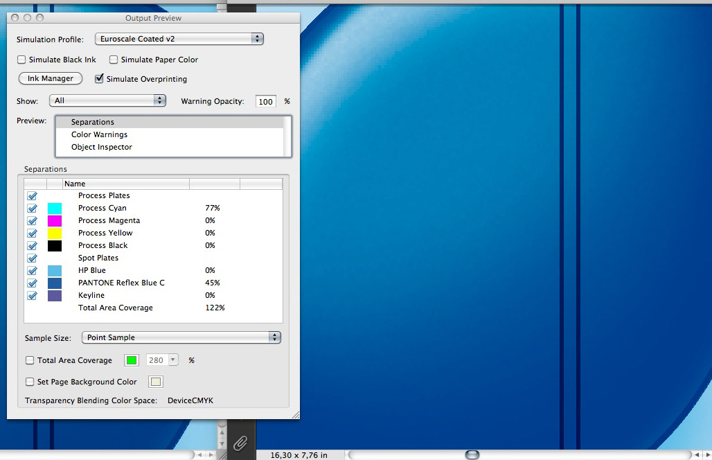

Has anyone tested yet to see if this resolves the issue we are experiencing?
The problem appears to be fixed. I have attached a successful PDF/X4:2008. I tried to upload the source files I used but couldn't get it to upload the ZIP file.
I just updated to Illustrator CS5 15.0.2 and the bug has been fixed. The testing I did so far seems to work just fine. Has anyone else had the same results.
Thanks for all the input.
Wel I have tested it to, the good news is, SpotColors are ok.
But now there is a CMYK conversion where it shouldend be:=(
In the Examples you can see what it should be and what it is now in CS5, this realy sucks.
