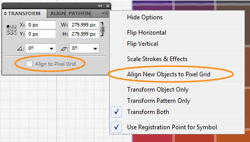

Yes!!!! A buried pixel snapping option in a vector program is exactly what I've always needed. Not only do vertical and horizontal lines consistently fly around at a rate of 0.5px -- but you are also unable to force it to the correct position by manually typing in the transform box. This handy feature is also a good way to get a new keyboard after smashing the old one with frustration.
attachment.php
Yes it's great for some, and I know others that have been so frustrated by spacing not being consistent as a result of pixel grid snapping. Important to know of it's existence!
