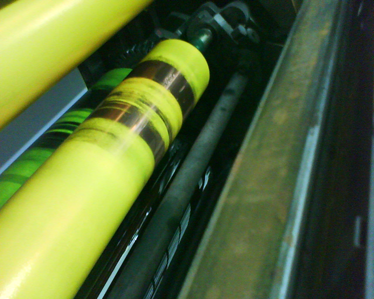

Roller Stripping
Roller Stripping
pacificiam,
Do any of the KCMY unit Roller Trains have this likeness, see posted JPG image, especially the Cyan Unit ???
Regards, Alois
pacificiam,
Regards, Alois
we dont have this type of roller stripping.
