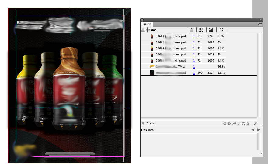

I have a customer who is constantly sending me in files with a large image (97 inches x 103 inches) scaled to 3% . . . are there any recommendations for the maximum reduction from adobe that anyone know about - I try to educate this customer but they just don't listen . . . if I can show them a recommendation from adobe it might help . . .
I would imagine that image quality would educate them more so than a recommendation from Adobe, however I could be wrong (who cares about image quality today anyway?)...
Copy the images, resample them down to the appropriate physical size and resolution and give them an appropriate sharpen... or let a script do most of the heavy lifting for you:

Lukas . .. the effective ppi . . . ah yes see the screen shot . . . the problem was I kept getting out of memory problems when I tried to print it from both CS5 and CS6 . . . I have 13 gigs of RAM . . .
