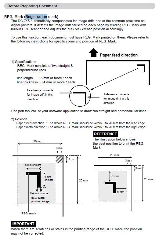

no. there is no such "standard". Nothing that would be CGATS, ANSI or ISO - It is silly to say there is or should be. There might be many 'specifications' that are put out by manufacturers that request some manner of tolerance that they need for cutting to trim, but that is merely a 'specification" - more a 'request that you help me make things the way you expected' - I certain that everyone realizes that heat and moisture can change the dimensions of substrate and sometimes that is asymmetrically. and the printing process amtters too (Digital, offset, rotogravure - oh, and flexo would be different as well.
Depends on what we are printing, what we are printing on, what method of printing - and what I am using to cut with.
A Duplo slitter cutter expects that you place a registration mark on the sheet to compensate for image drift - image drift as defined as the printed image is often not place exactly is the same exact location - so, the Duplo will "move" the blades slightly to compensate. I know of a few folks who make full bleed Business cards where they are imposed 3.5x2 and slit - so, while the PDF file may have bleed, they are imposed without and "space" or "gutter" between the cards and slit to the final 3.5x2 size.
It is a manufacturing specification request, and there is no such "standard". Might be some popular 'amount' or what we might consider a "defacto standard" but that just people flapping their gums.

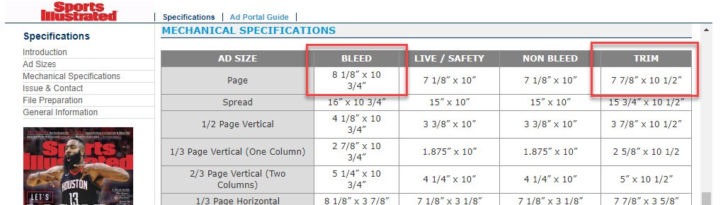

Years back, when Time Inc began considering accepting digital ads ( this was even BEFORE PDF ) the published specification. When I worked as the product Marketing manager at AGFA for Apogee version 1, we had to provide imposition tools ( via an OEM version of Preps ) so, we needed bleed and trim defined. But when time published the specification that their advertisers submitting ads needed to follow, they asked RRD ( now printed by Meridith ) for help.
Today, that is all published on line ( ask your designer friend if her ever had to prepare an add for Sports Illustrated ) - LOL - yeah, I will not hold my breath...
http://www.direct2time.com/title/sports illustrated/#mechanicals
so, looking at a full bleed add, submitted to Time Inc. for a full page add - that is 8.125 x 10.75 bleed - 7.875 x 10.5 trim - so, .125 bleed on each side
So ef this designer guy.
I was part of the team from AGFA and DDAP (Gary Cosimini was there from Adobe, Alan Darling represented DDAP ) that presented this to the Ad Agencies and Printers on behalf of Time Inc at their headquarters ( back then it was Time Warner ) this was when they first announced they were no longer accepting film, would accept TIFF/IT-P1 files for a short time, but would ONLY accept PDF/X-1a file by June 1st 2001
And yeah, the 'specification" for ALL times titles was .125 bleed on all sides.
