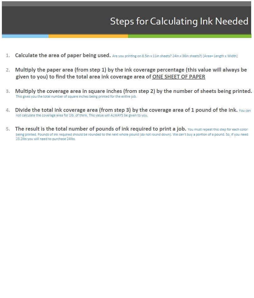

In attachment file you can see one of the methods for calculationg amount of needed ink. Notice what is written with blue font in point 4 (You can not calculate the coverage area for 1lb. of think. This value will ALWAYS be given to you.) So i needed exactly this information with 1 lb how much area can be covered. I turned to couple of ink distributors and ask them for this info but nobody gives me the anwser :/

hardtemper, I looked at that and that is OK, however back to my EZ formula using offset as Standard. I am better awake now.
Offset Ink
1 lb. of ink for a solid sheet 8.5 x 11 will give you 3,333 impressions on coated stock.
1 lb. of ink for a solid sheet 8.5 x 11 will give you 2,222 impressions on uncoated stock.
