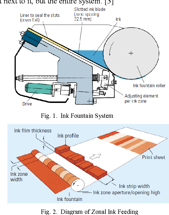

Gentlemen and majklcze,
Ink Pre- Setting Systems, produce - Zonal Ink Slide setting via the Ink Duct, which reproduces the inputs into a ..... Roller Train Inking Profile.
NOT ....Curves!
Regards, Alois,
NOT ....Curves!
Regards, Alois,

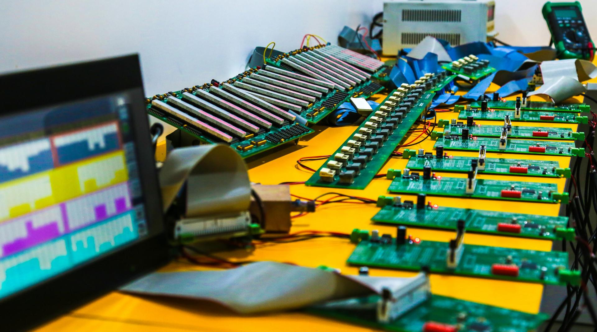

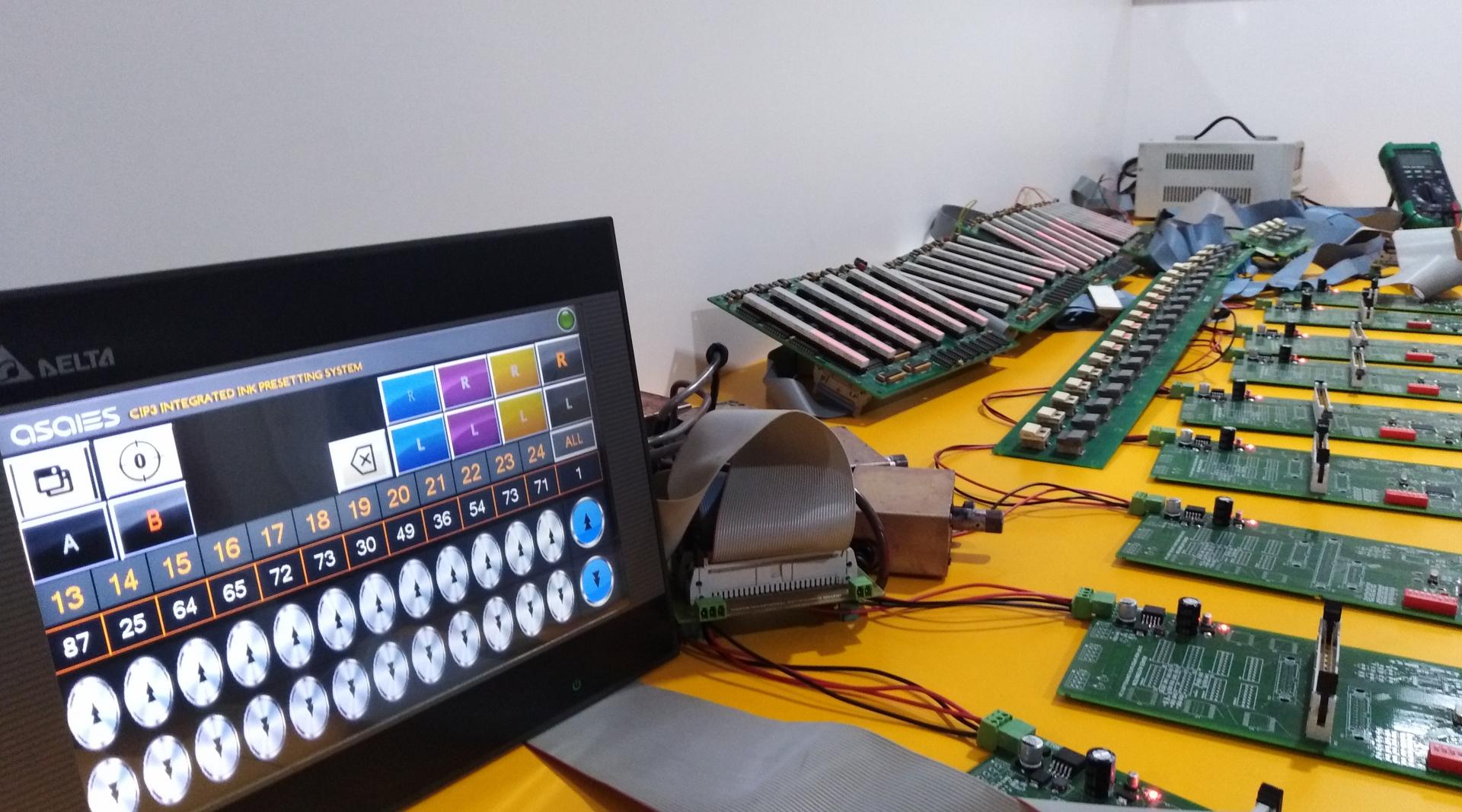

Hi everybody,
I would like to share you our achievements in developing a customized ink presetting system for a double width TKS Web Offset Press.
Some of the Ink key controllers were faulty and spares were not available. Replacing the whole system would have been much more costly for the customer. So we have developed a customized ink key controller compatible with their existing motor drive boards and and also developed a CIP3 based software which can process 1 bit tiff files for automatic ink presetting. Everyone was so happy with its excellent results; after running for one month we got the second order too. This time we had to just put the controllers and our HMI based operator console and integrate with our existing CIP3 server system.
We have just completed another customisation of our ink presetting system for a Harris press making it also compatible with their existing machine keyboard and led display. Apart from the HMI based operator console, the system also provide a web interface for configuration, file preview and profile setting etc. Pls watch a video of the web interface here. https://youtu.be/08Ilh4BNZq8
Also find a recent article in Printweek regarding our developments.
http://www.printweek.in/News/malayal...-setting-41401
Please feel free to get in touch with us for customized and affordable Ink Presetting Systems.
