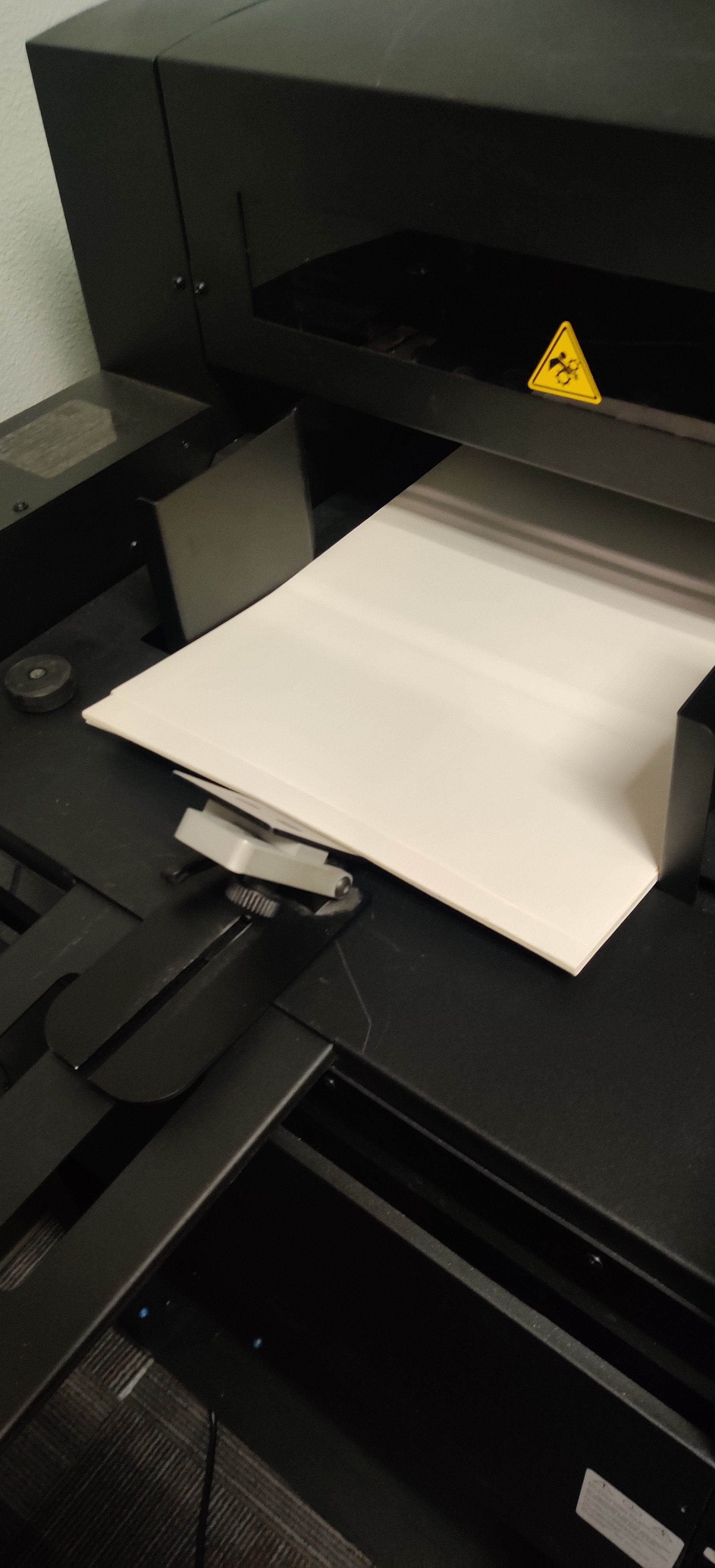

We also found making kind of a scoop for the stack instead of using the back stop helped with skew. With the back stop the sheets like to buckle when it's reading marks, but a scoop, or something to sort of shingle the sheets allowed the sheets to just ride up the stack as it registers the media. I can upload a photo if this doesn't make sense.
I'd like to see a photo of that. We've experienced the same problem you're both describing.
I'd like to see a photo. I'm having an issue now with the metal output ledge being too short and running 13 x 19 sheets. I'll have to be creative on how to run these sheets so as not to skew them on the trailing edge.
I stole it off of an old straight shooter envelope feeder that was broken. It just leaves the stack lifted at the tail edge so It can ride up the stack instead of buckle. The only annoying part is finding a magnet so you can hold it in place.
