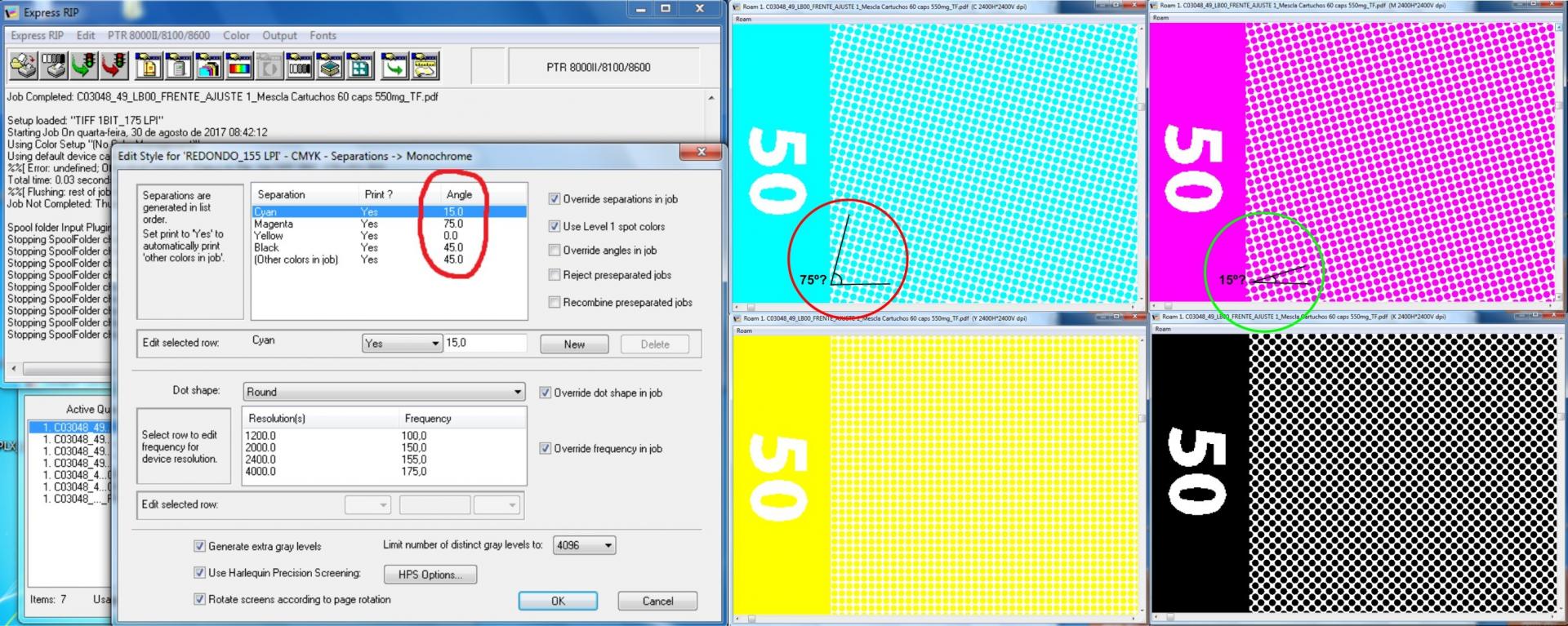

Could someone tell me if it is normal what happened to me?
It looks like the Angle of Cyan and Magenta were reversed.
I set up the cyan with 15º and the magenta with 75º, but on the plate the cyan is left with 75º and the magenta with 15º.
Thank you all for helping me.

For some reason the angles you've selected are not being honoured by the RIP. Did you try checking "Override angles in job"? Unfortunately I don't know the Harlequin RIP so I don't know why it's not honouring your request. I would contact Harlequin support on that question.
The angles I suggested for tri-tones puts the 3 screens 30° apart which minimizes inter screen moiré and results in a rosette. The sequence from dark ink to light is from least visible angle to most. If you cannot use those angles then it's possible, but not guaranteed, that the image may not appear at its best. Put another way, you may not see a practical difference in production. The more important thing is that the angles that are used are 30° apart.

Many thanks Gordo !!
So I'm not crazy, my rip is reversing the angles of C and M.
I will try to change the settings to see what happens.

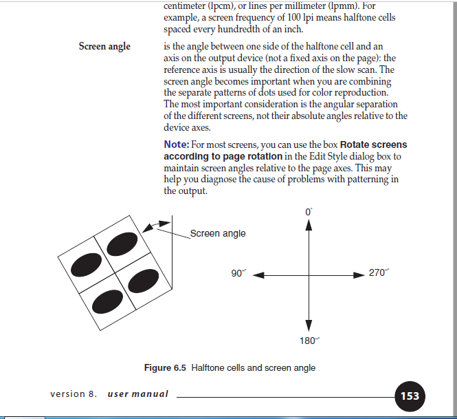

I found the harlequin manual !!!
I'm trying to understand the way RIP interprets the angles.

My RIP (Apogee Prepress version 10) matches yours. Same angles, same result.
If you measure the angle clockwise instead of widdershins you'd measure cyan at 15 and magenta at 75. You could still have your angle line move "up" if you draw it from the right end. What would be most intuitive to me would be to set the base line vertical and the measurement line rotate clockwise from the bottom end.
I don't believe the method of measurement has been standardized anywhere (please correct me if I'm wrong), so both interpretations are probably equally correct.
