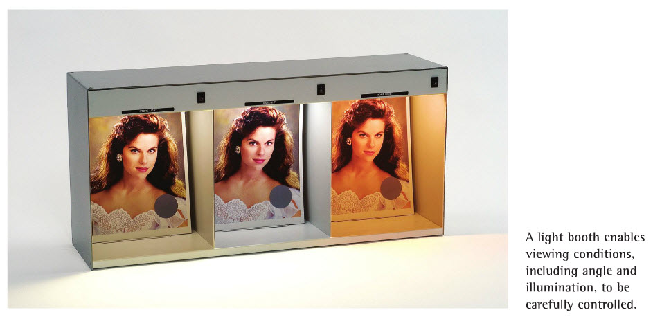

Metamerism is a little like Murphy's law ... it often occurs when you least want it.
The Graphic Arts & Photographic industries decided many decades ago (mid 60's as British Standard BS-950 or early 70's as ANSI PH-2030) that the materials used in printing and photographic reproduction were not highly susceptible to metamerism (e.g. had comparable spectral reflectance curves) so critical color evaluations and color approvals could take place under a single light source (D50). [side note: since process color printing was mostly being produced on one and two color presses back then, there was an additional light source (D75) specified for use in the press room to allow easy detection of color shift with the yellow printer. The D75 is a bluer simulation of natural daylight and made it easier to see the yellow ink on white paper. D75 was removed from the ANSI standard in the 1989 version of PH2.30.
This has worked quite well for the industry except for packaging, digital printing, textile printing, and any other graphics application that uses colorants and substrates with different reflectance characteristics. In this case there is a good argument to be made to incorporate multiple light sources (with different spectral power distributions) to visually check a color match. This is the norm in nearly every other color critical industry (plastics, textile, paint coatings, food for example). Viewing booths are available that provide D50 along with two additional light sources (typically Incandescent A and Cool White Fluorescent) to allow you to confirm an excellent (non-metameric) color match plus put on your 'aesthetic evaluation' hat and see what the color will look like in a "real world" (store or home) location.
The comments posted earlier are correct. The metamerism you experienced is a result of the differences between the toner based inks and substrate used in your Xerox printer and the pigment based inks and substrate used on the offset piece. Checking the color match under a multi-light source viewing system will inform you of the issue and the degree of mis-match that will occur, but does not change the basic physics of what is happening.
Here are a couple related technotes on this subject.
