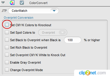

In prinergy you should check your settings in colorconvert section of the refine process. Look for overprint conversion options. You can set all CMYK to knockout via first checkbox:

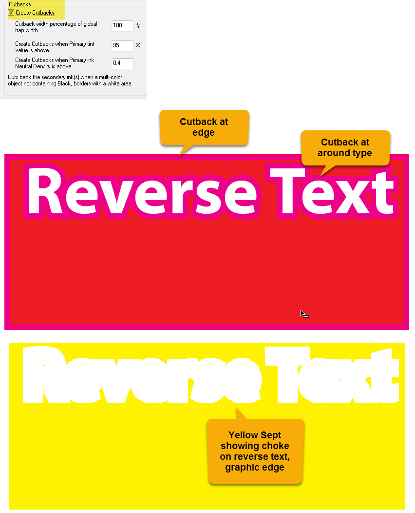

Yes, it's possible by using the Cutback feature in the Prinergy trapper. It's the same idea as Rich Black trapping, where CMY gets pulled back from all white (non-ink) edges. This is also often referred to as pull-back. The Cutback feature in Prinergy is separate from automatic Rich Black trapping, as Cutback was designed for "Spotless" (expanded gamut printing) where many solid objects are composite colors made without Black and users often want separate controls for these. All other inks get choked back from the "Primary" (darkest) non-black ink in the blend.
I've included a screen capture that shows Cutback settings in the Trap Editor and results after applying cutback to the Red object.

Anyway, one need to buy advanced trapping feature to use cutback.
