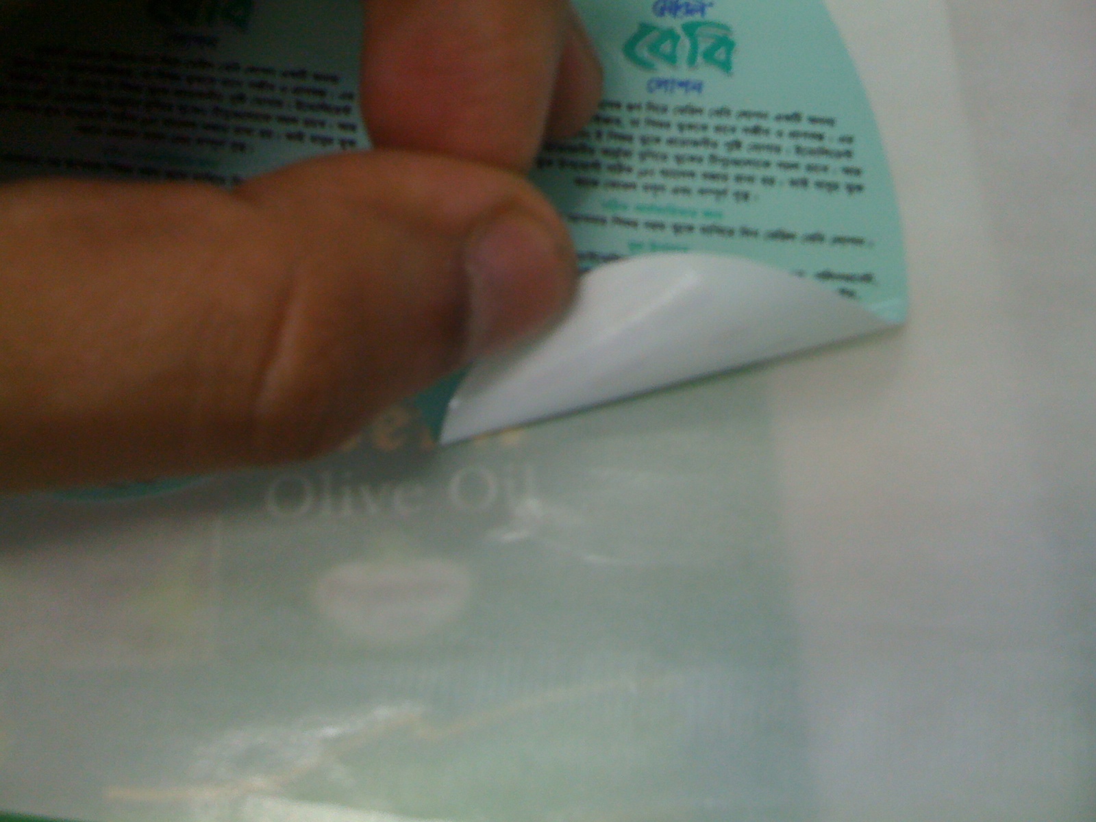

I already operate in conventional (offset) printing. The plan is to diversify ....so sort of did a market survey of what the market is missing at the moment ( I am in Bangladesh). Found out that there is no one doing printing jobs for PP/PE sticker labels for consumer products like Shampoo, hand wash etc.
SO ..basically i have a very little know how on this matter.
Can PP/PE stickers be printed on a uv inter-deck systems? is it a good system to do this sort of jobs?
PLEASE HELP :(
i am attaching a pic of the material
Dont even try to print labels on a sheetfed mashine. It is not worth it. Nowadays, people want their labels printed on a reel , diecutted and creared. The reason is that, labeling machines only work with reels. So what u need is a reel to reel printing machine, Flexo or letterpress (depends on your production volume), semi-rotary or rotary (depends on your budget and production volume), the according prepress and finishing. Try some consulting first at Webtech
