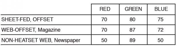

Traditional values can be found in the png below :
measured with Status T and calculated with Preucil formula.
Trapping is not standardised by ISO12647, but can be a parameter that gives you a fast check on the printing quality.
Regards PGe

Absolutely right, sorry I should've been clearer when making the post but what PGE stated was correct. Thanks
