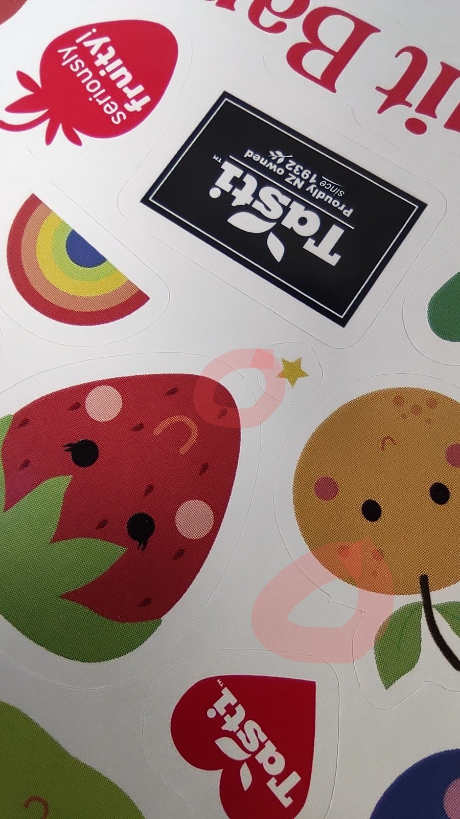

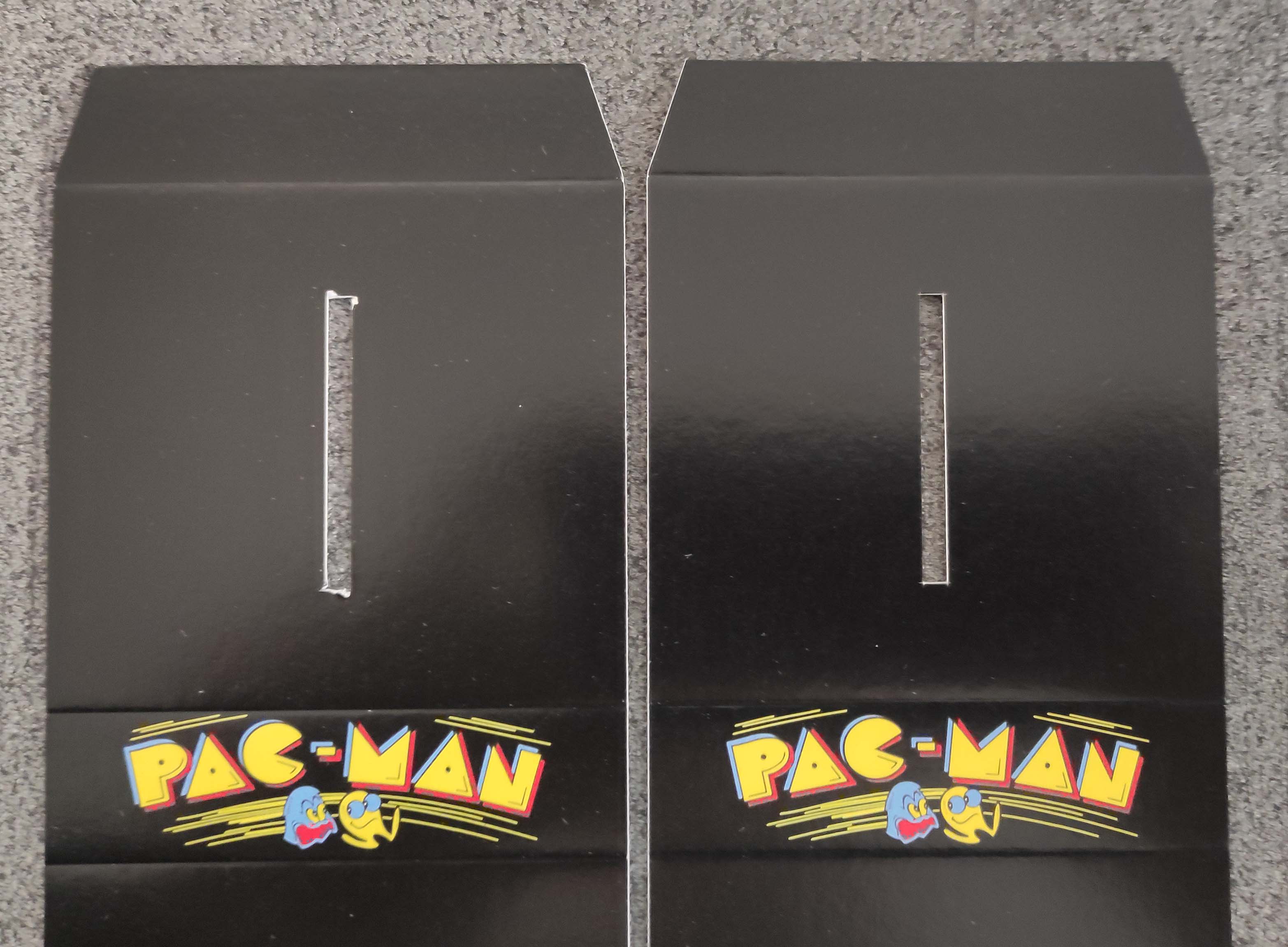

Couple of things I'm working through is quality of the cuts when using the K3 tool (standard drag knife). Before I had an Intec which offered a knife offset setting which meant that tight corners are infact tight. Using the K3 tool we're getting a weird swivel motion meaning not perfect cutings. When i switch the to "directional knife" it's perfect, just slower.

Thanks for the tips! I'll check the level although I do know it was levelled when installed. Might've settled a bit.
Have you had any luck getting a nice square cut with the K3 tool? Attached is a pic of the K3 cut vs the "directional cut" tool.
The kiss cut labels show where the tool starts and does a weird swivel.
