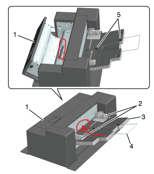

Are you feeding from the bypass tray or do you have the PF-812 paper deck?
At what point does the jam indicate? I.e. does the substrate register and start feeding?
He has to be feeding from the bypass tray. The PF-812 only supports up to 35.43" per the specs.
@dundi , we run a lot of banner sheets on our C7090 (mostly 100# gloss cover). We find it jams due to paper dust building up on the rollers for the bypass tray (reminds us how beneficial the vacuum drawers are!) We keep a wet rag at the press to wipe down the initial rollers that first touch the paper, and then the wider rollers that are under the top flap of the bypass tray. We've also found we can't load more than 1/4" thick stack of banner sheets into the bypass at a time. Also, are you pressing "force print" on the touch screen? If so, then either the job specs or the bypass specs are not matching and the machine will jam because it's expecting one size and getting another.
