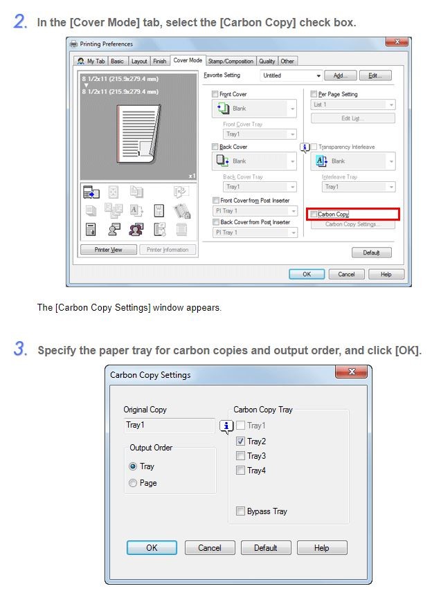

could anyone help to resolve this issue: I need to print variable data (about 40k records) on carbonless paper, multiple copies for each record on different colours of paper, from multiple trays. I found there is a function in some of the KM Bizhub presses which is called "Carbon Copy" (see the attachment) and it does exactly what I need: prints the same page from multiple trays, but my driver doesn't have it. Is there any way to upgrade the driver or firmware for this function to work with our press (KM Bizhub Pro 1050)?

I'm running Windows 10, so I don't have the ability to install the 1050 or 1051 PCL driver on my PC, but I did install the 1052 PCL driver, and thought I had found a workaround, but it didn't pan out. I tried also with the 1052 PS Plugin driver, and that didn't pan out either. But I noted that the Konica 958 PCL driver also has the Carbon Copy feature. That same driver is used for a range of Konica workgroup machines.
So how about this: Try the Konica PCL driver for workgroup machines, like the bizhub 958, but use it to print to your 1050. Not promising anything...this is totally experimental...but assuming there is some similarity between the print controller for the 958 and the 1050, I wonder if that would work. Chances are, not...but it's worth a shot...

I've tried various 1050/1051 drivers, I'll give a try to 958 driver then, need to check if that Carbon mode is available beforehand. Thanks for the tip anyway.
Oh, it's in there . . . I checked it out.
I have installed 958 driver, Carbon Copy is there but it prints only master page, doesn't pull from other trays, regardless of which tray is set for original copy.
Perhaps is more to it than just a printer driver? Maybe this function is hardware/firmware supported?
You're probably right. Like I said, it was just experimental -- at best, a workaround. Sorry it didn't pan out.
I've applied for KM Developer Support Program, I should get an access to their SDK, so I can ask my friend programmer to spit out a few lines of code for this specific task. Maybe this will make it. Thanks for all the responses, much appreciated!
