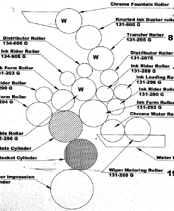

Does your newer press roller train look anything like this. This is probably the same as your old Chambon
The rollers marked W are water cooled

Yes for the most part that is what our Ink Train looks like in our offset units I’m sure the older Chambon is similar to mine.
The only difference I can tell between this diagram and the ink train diagrams we have at the plant is, there may be som subtle differences in roller locations under the “ink ball” or “chrome fountain roller” and our rollers are all labeled with letters (I.e. A form, B form, C form, D, F, G, H, I, J, K.) Not sure that matters or may have just been a change in labeling from Komori at some point.
By the way, where did you come up with that diagram image?
Its from an old Chambon Roller identification sheet. They never had one that described the roller stripe or Durometer, that you had to learn by yourself
