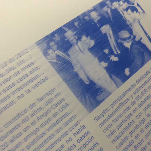

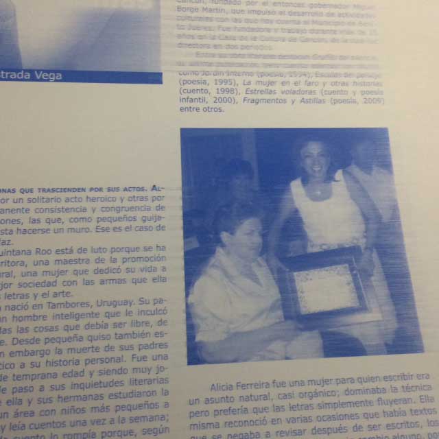

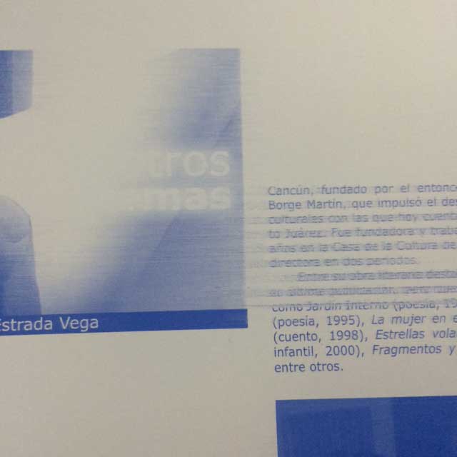

Hi. After exposing a plate on Lotem 400 i'm getting a image like ghosty. foto-1.jpg foto-5.jpgfoto-4.jpg

Thanks Les, indeed the problem of laser was due to poor conditions in the environment. Required to be colder.
For the image exposure problems, the TSP card was causing problems, it was necessary to clean the slots that are inserted into the PCI port with an eraser and that solved it .
