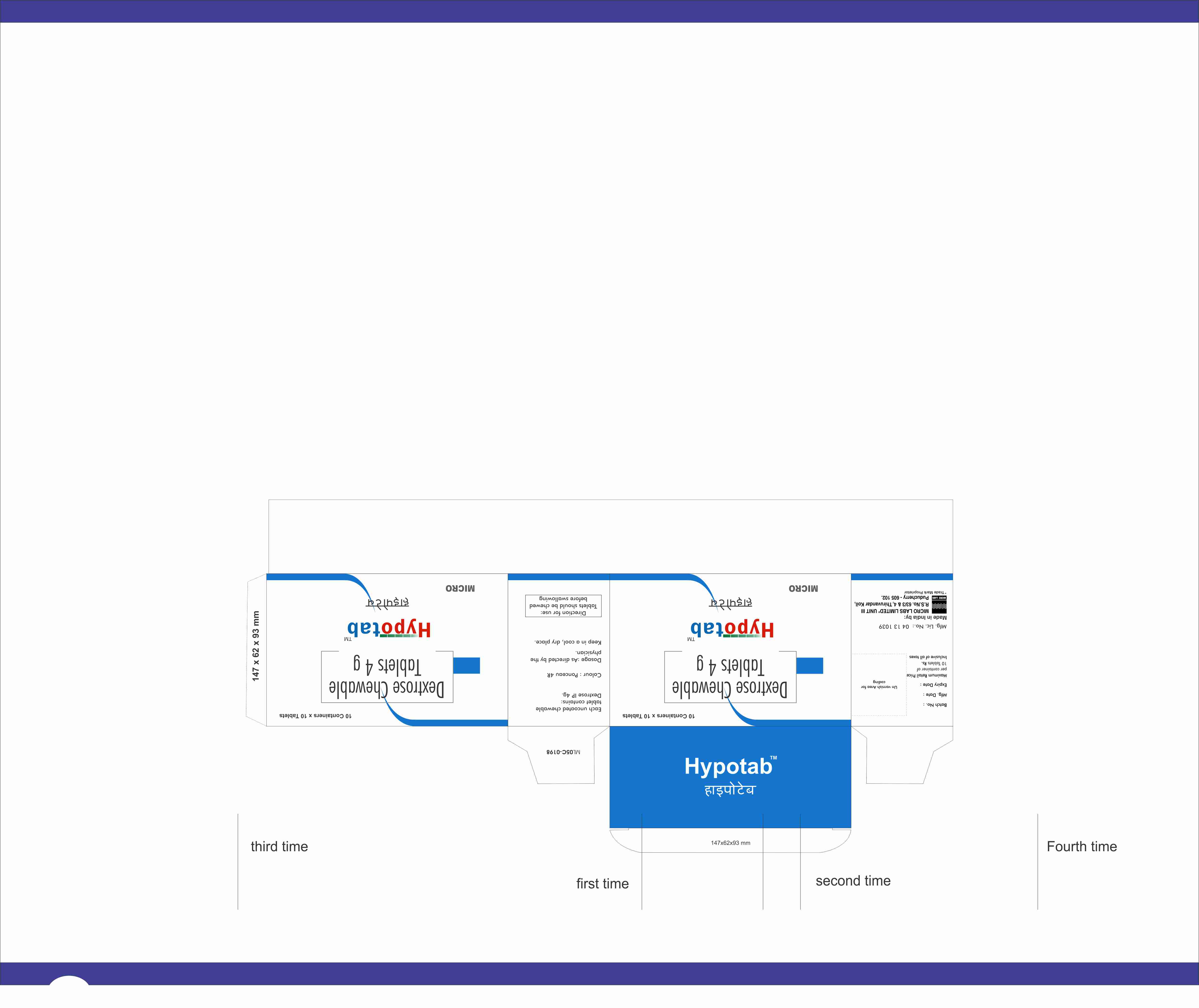

View attachment 3045View attachment 3046 images for gripper difference as mentioned in earlier message..
Regarding Gripper Difference , tried increasing X in drum final from -12 to -14 ; nothing happened tried increase y in drum from 12 to 14 nothing happened.....
Planned to change the suckers ; Finally will do the spiral punch adjustment as advised by patch....

Once you are happy with the depth of the Spiral punh hole, as I said before just remove the molex connector that drives the horizontal movement of the punch. Like this the punch will stay in one position. You will always need the Spiral punch hole on the plate .
There is a procedure for adjusting the Spiral Punch.

View attachment line problem.jpgHi Patch / Nemo
Awaiting for Plate air suckers new to replace the old one for gripper difference...
Apart from that iam getting small black thin lines on gripper side here and there on few plates not all the plates.. (pls find image attached) ; its not coming on fixed place its coming here and there as attached image ....
Sometimes double lines like roller some times single line sometime at starting and some time at middle sometime at end but most of the time punch side ie lefthand side on plate ...
And also kindly notethat the lines are possible to remove thro remover so defintely its not laser lines its like roller marks but which place that we have no idea

Kala,
Make sure that all the black small rollers that the plate is moved over rotate freely. Could be plate dust deposit inside these rollers. You can remove all these rollers from the side of the Lotem,RHS if I remember well.A long time ago there was a change of these hard rollers to softer ones. YOu take all the rollers off and clean well the shaft that they are on and inside of the rollers. Have a go. Another place that the plate can get scrathed is the "plate leader" assy that is under the drum. This assy can also be removed to clean the black rollers.
