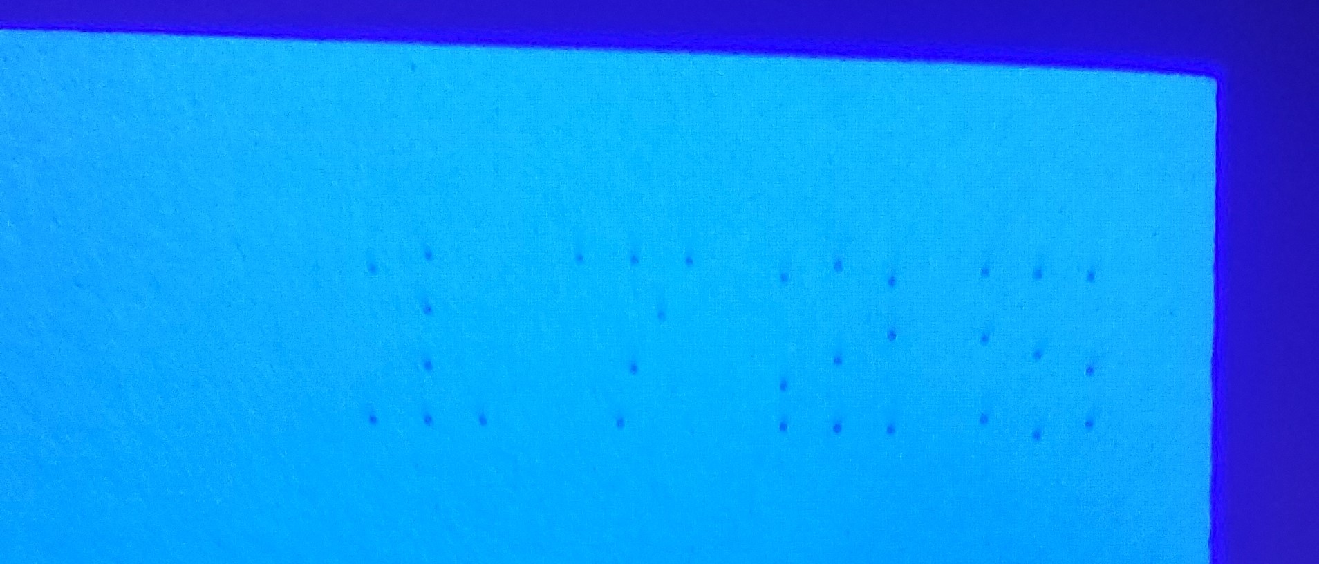

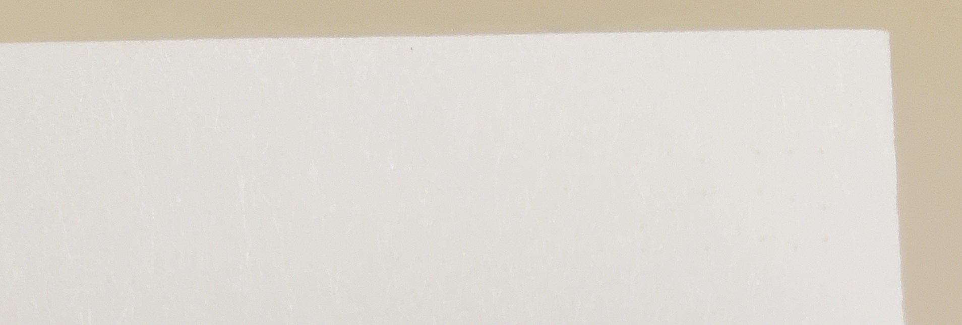

Don't have a 5th color, but my experiment worked. I modified my microdot font (actually made the dots bigger to print at a small size) that I created for ballots and ballot applications. The font made it minimal, but I couldn't figure out how to make it near invisible. Then I remembered an old Ikea billboard that was done in CMY and they changed messages by shining R, G, & B lights on it. I placed the sequence in the upper right corner in pure Y. It's very difficult to see even when you know it's there. But when you shine a blue light on it (thank you Amazon for same day delivery) it's clearly visible. I just used a small blue LED flashlight for the test. I can clamp a lamp onto the inserter and put a blue LED bulb in there. Finally got a picture. Sample is 14 pt.

View attachment 291091 View attachment 291092
Share your microdot font, pelase? DM ok. :)
