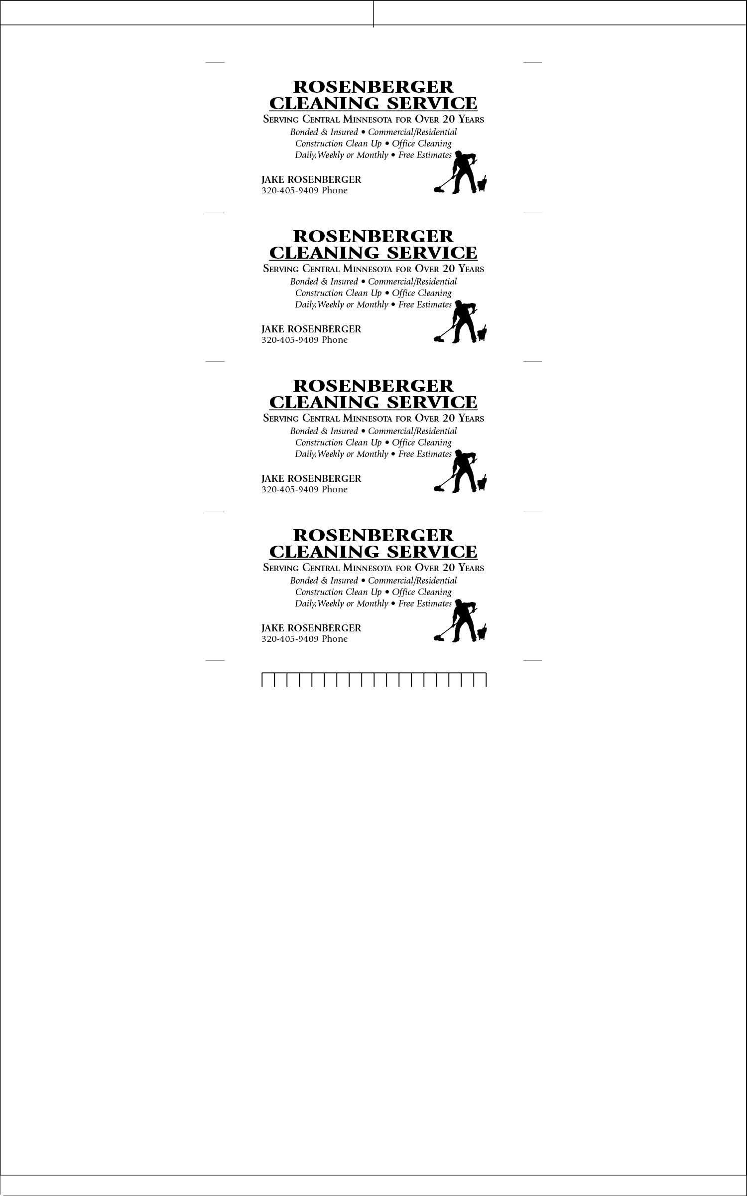

I ran with Van Son Rubber Base and Van Son CML-Oil Base inks both ran without an issue. After running 100 small jobs and you are accustomed to them, they run just like a metal plate in terms of quality. I made a template in InDesign for the actual plate size which is the 10" x 15" (length can vary depending on what plate cylinder is on your press. I then "placed" the PDF or Indesign layout with the correct margin specs to locate the image with great control onto the plate. I printed all my plates on the 12x19.375" plate material and used a trimmer to cut the plate to the proper outer dimension which I printed onto the plate from the templates I made. The attached JPG sample has black borders for trimming the printed plate to final size from the plate material.
