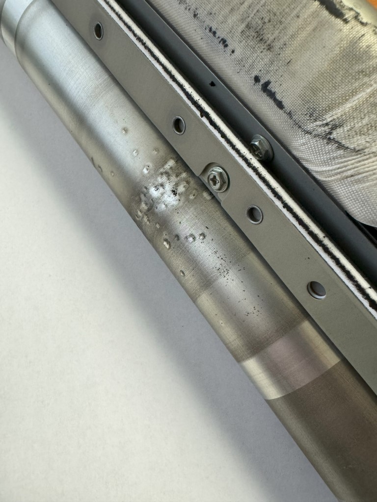

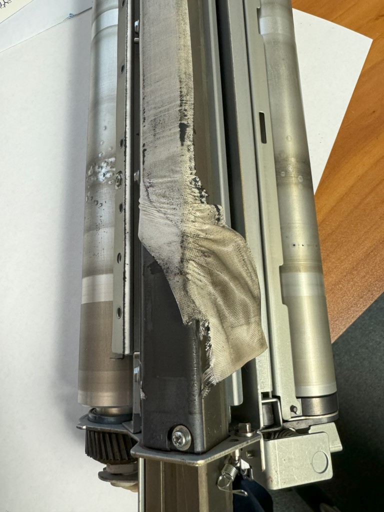

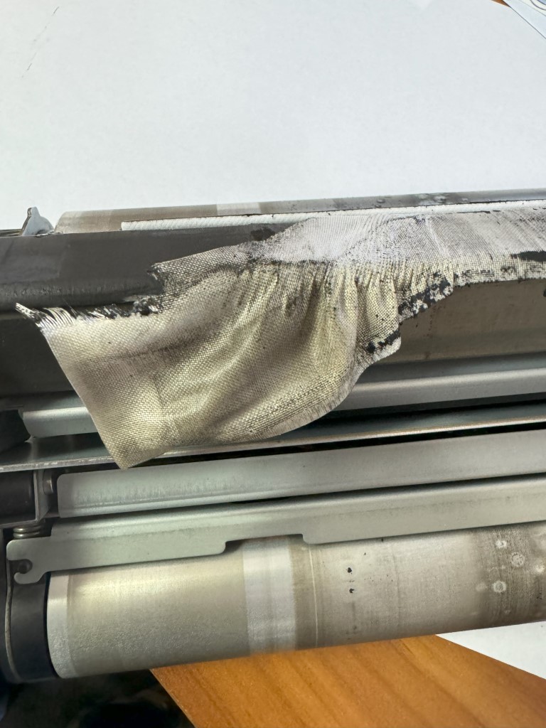

Found it Slip sheet was shot.
Both wicks were dry, lots of buildup.
Cleaned unit replaced, belt, slipsheet and wicks.
Running like new and a lot cheaper than entire new assembly.
Thanks again for all your support.
