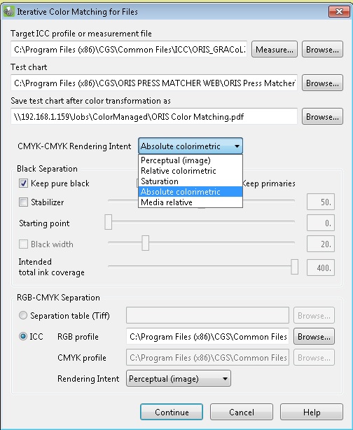

Okay I will generate a profile using Absolute rendering intent on the CMYK-CMYK conversions. Should I leave the RGB-to-CMYK conversions at Perceptual or also change that to Absolute?
Thanks!
Hello Mitch,
For proofing, it's usually done with Absolute rendering intent when you want the proof to have dots on the proofing paper on the paper area of the printed file, simulating the source icc profile's white point.
However, if you are running the RIP with different source and destination icc profile, you'll want to use the relative rendering intent to avoid adding dots to the paper area.
For RGB to CMYK conversions, it really depends on how you are treating the RGBs for proofing and printing. If you leave RGB files in your PDFs to be handled by ORIS, then you'll have to make sure you do the same setting on the proofer software to match what the ORIS does to the RGBs.
Can you clarify a little bit on the ORIS and Fuji ColorPath Sync though? Am I correct that you are only using the ORIS for proofing on the inkjet and using FujiColorPath Sync with only curve adjustments by G7 method and not a Devicelink transformation for your Press adjustment? The reason I'm asking this is that the G7 method is a gray calibration tool and not a color management tool. Your digital press is gray calibration but it is, with a very high probability, NOT color matching to the GRACoL or FOGRA to an average delta E of your acceptable range.
Hope this helps a bit.
Kent
