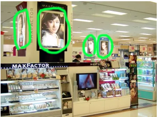

Just for reference, I attached an image of the type of backlit posters that I am talking about although these are not what we produce.
