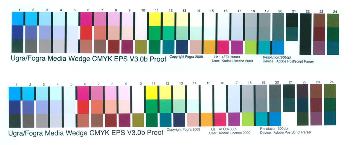

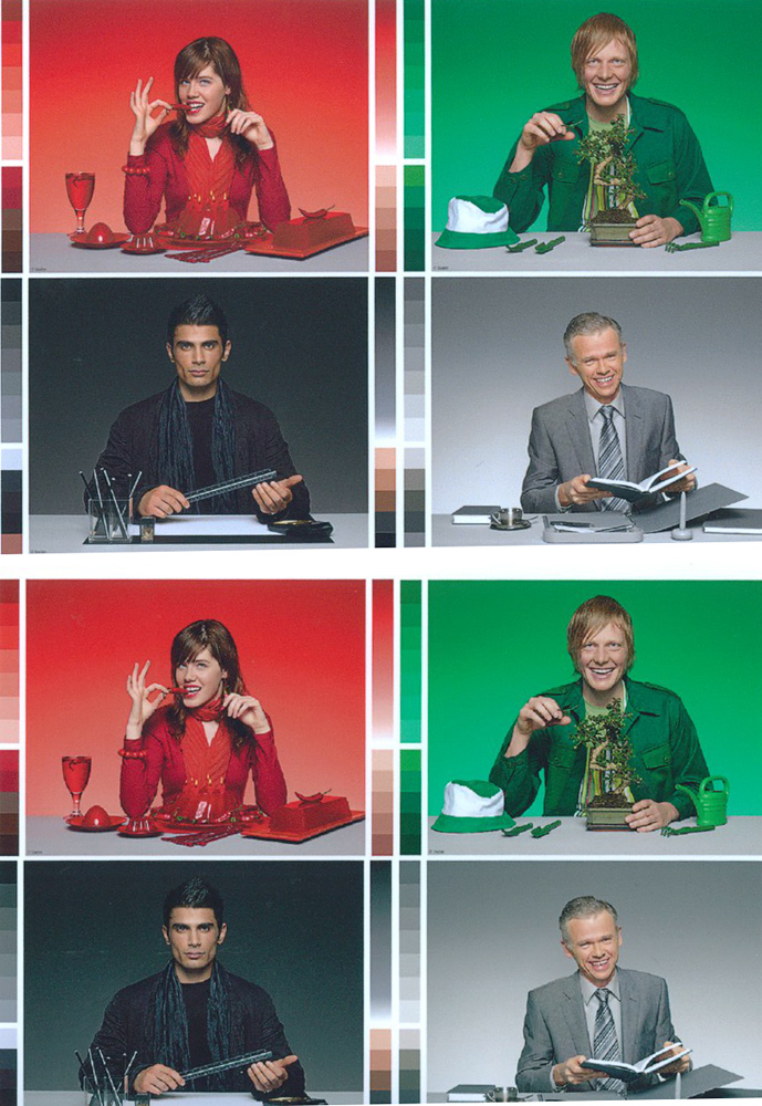

Two images attached (each 2up), one of colour bars and one of some images.
In each case, one image was proofed via a RIP, the other through Acrobat Reader and the Epson printer driver using a PDF/X file and Epson driver colour settings and driver profiles for the same media used by the RIP which used different profiles and settings for the same media (Epson Standard Proofing Paper 240). As Epson printer driver requires OEM media for accurate out of the box results, I proofed on this same media so that it would be an apples to apples test. In each case, it was attempted to create the “best” proof of Fogra39.
They are not exactly the same, however one is not totally different than the other, they are closer together than further apart – unlike the situation described in the OP where the non RIP print was very saturated and vibrant and not at all like a press simulation. Note that the scanner has exaggerated the differences more so than when viewing the prints.
One set of prints pass Fogra39 verification with a spectro, the other does not.
My point being that visually, if one does things correctly – one can get “visually quite close” to the results of a calibrated and profiled proofing solution (close but no cigar, the RIP wins hands down on many points).
