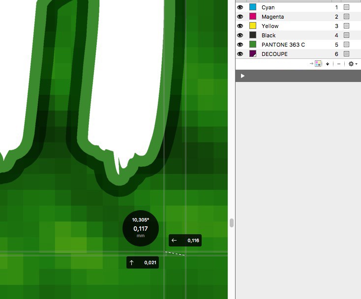

I've found something about it in a newly arrived job...
A thin line (0,1mm) on the bound between white and colored areas, made with a 5th spot color.
