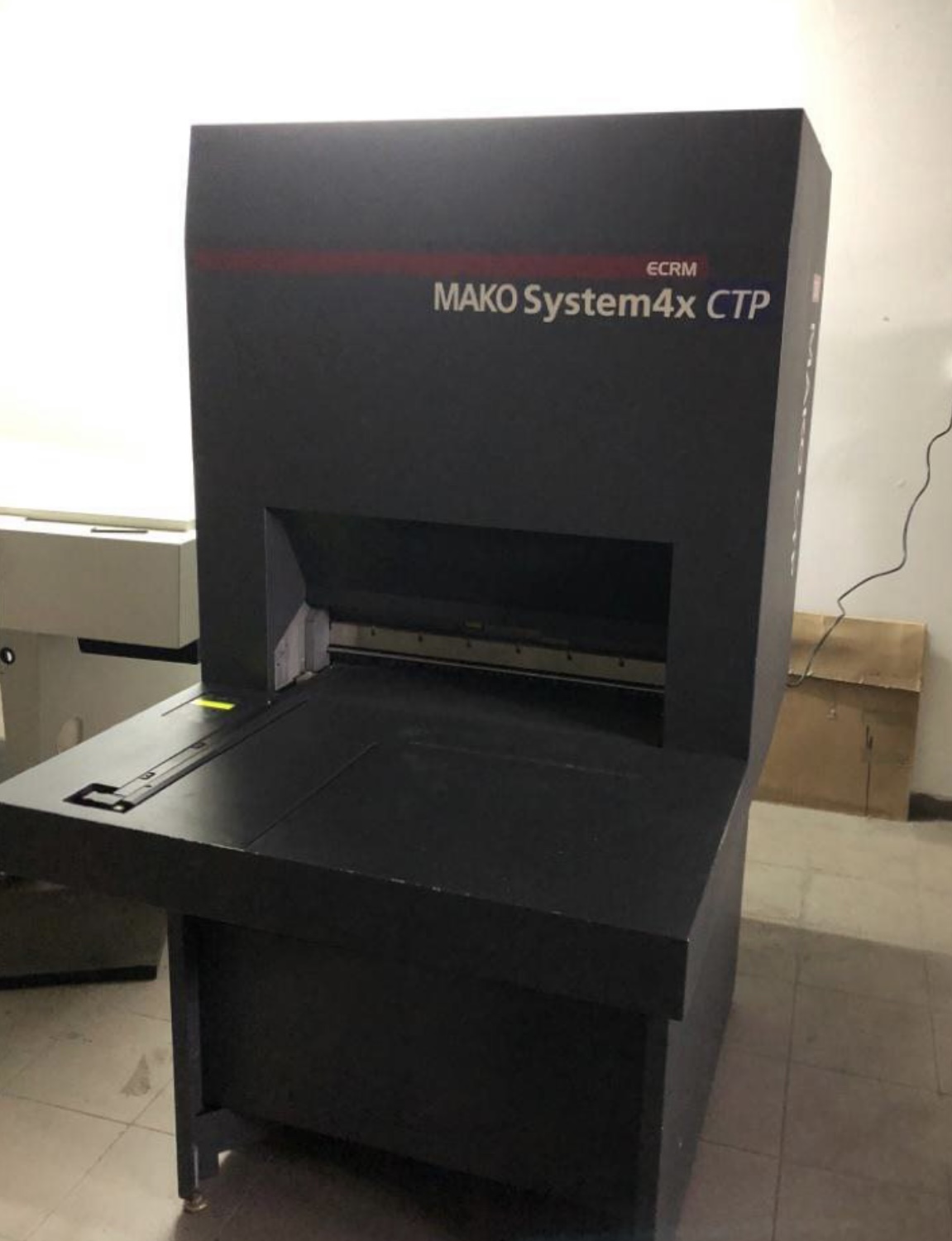

Yes ,but, we are a small weekly publication. We print less than 5000 copies of a 24 to 32 page tabloid .We use a 24X36 inches size plate
A 32-page tabloid, even if it’s entirely CMYK, is only 64 plates a week. At 5 minutes a plate, that’s a little over 5 hours of usage per week. Seems like you might be better off partnering with a nearby company (a trade shop or commercial printer or whatever) to get your plates made. Unless, of course, you can justify the purchase because of other work. Or if the nature of your publication is such that you may need plates super quick due to last-minute edits.
