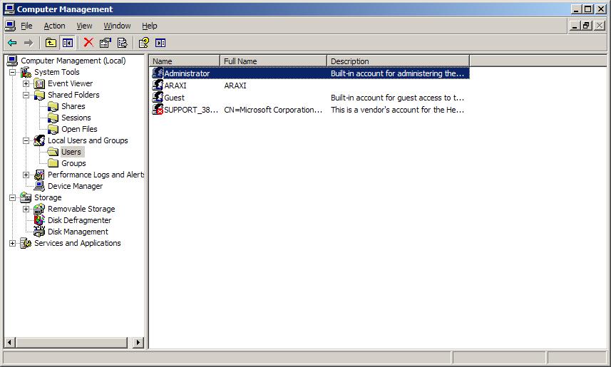

It's not under Shared Folders. It's further down under Users and Groups. Click the plus sign to the left and then click Users. In the right pane you will see the list of Windows 2003 users. You must connect using one of the user accounts.
Here is a screen shot of where the users are listed on the Windows Server.

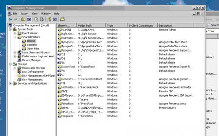

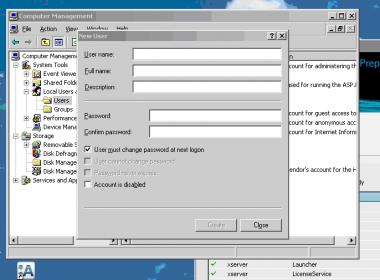

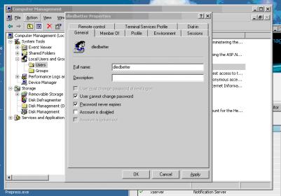

Sorry I misunderstood you, I thought you were connecting to the server like in this first screen shot I'm att: this will not mount SMB you have to browse to it.
Also when you create your user from new make sure you lock the user password and lock password never expires options is a good idea.
-Dan

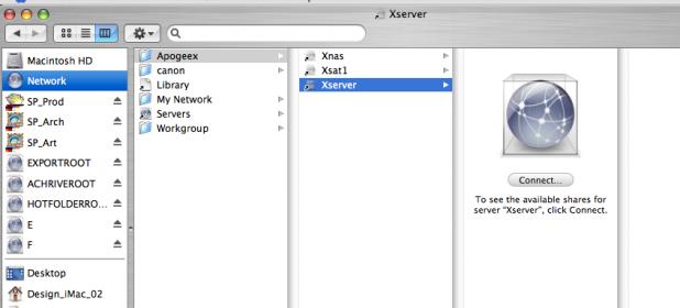

That was my understanding when our system was installed. I was told to mount my alias by browsing to the server rather than to search to it, maybe this was just the way the trainer preferred.
Maybe I'm missing something here but there are no mac and win shares it's all win at least on our system.
-Dan
We also do not have any Macintosh shares on our Prinergy servers but we do on a couple of our old proofing servers. You can either set the shares up as either Windows, Macintosh, or both. Whomever set yours up just did the Windows ones. Although if you have any version of Windows server newer than Windows Server 2003 you can't set up Macintosh (AFP) shares because Microsoft no longer includes it in their server product line. Unless you buy a 3rd party solution like Extreme Z-IP.
