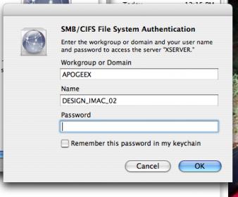

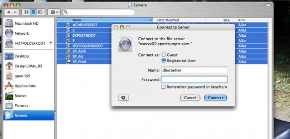

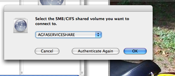

Hello Stephen,
These screen shots prob won't help, but I will upload them anyway.
We have a mac server and a nas server SMB mounting by browsing to the connection is how I connect, than I make alias of each volume and place in a folder to use when I start my mac.
-Dan
