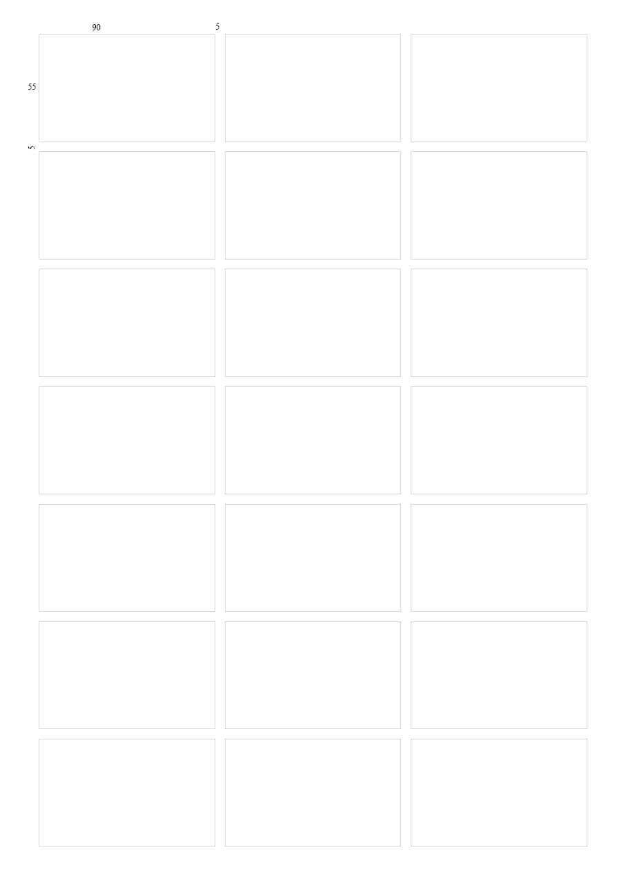

This will vary slightly for other places but i run mine 21 up on sra3. 5mm gutters 55 X 90mm

2. You mentioned that you utilize 5mm gutters. We set up our cards 9x5cm. Are the gutters left blank, is this on full bleed cards or might you have a couple of pics of cards layed out on a SRA3 page? Thanks, Kristian

2. You mentioned that you utilize 5mm gutters. We set up our cards 9x5cm. Are the gutters left blank, is this on full bleed cards or might you have a couple of pics of cards layed out on a SRA3 page? Think of it as having 2.5mm bleed off each card, i will get a pic of the next set i do and upload

MrKarter so i applied your method via youtube to a 11x17 24 up bcard job. it worked well...not perfect but passable. i would like for you to look at my comprehesion of a SRA3 21 up with gutters and let me know if this is how you would or do set up the job. i want to understand how you set up the gutters 1.75 bleed around the card, 3.5 between cards? thanks, kristian!
Not sure where you get the 1.75 and 3.5 from but here is an example of my layout
