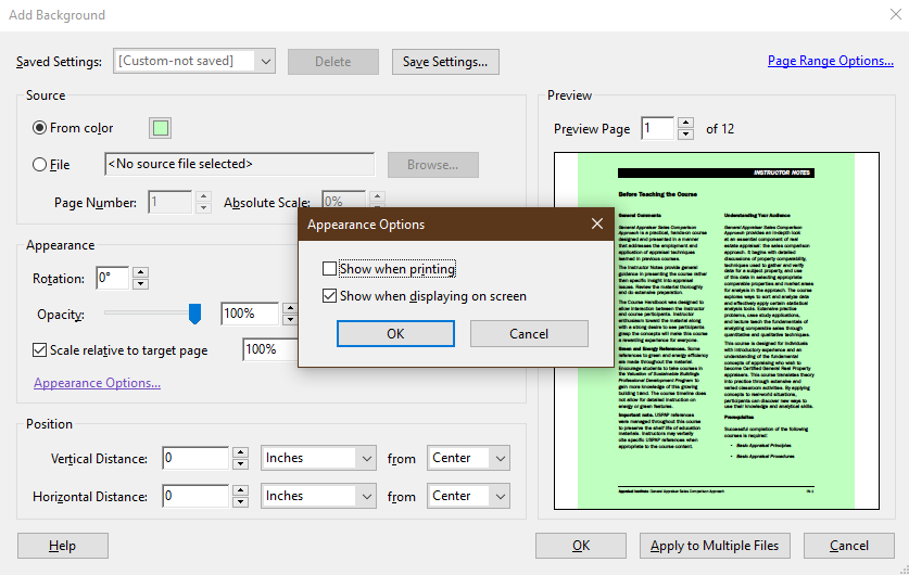

I know you can add a background with Pitstop actions, but can it be non-printing? I'd like to use this to simulate color of the stock in a PDF proof.

So close, I got it to work going to a laser printer, but when the pdf goes through my rip (PRISMAproduction), the layer prints (even thou PrintState : OFF). So my guess is that Pitstop's background and Acrobat's background are two different things. When I add a background using Acrobat and turn off "show when print" it goes through the rip just fine (without a background). When I have a color on a layer with the printstate set to OFF, it prints the layer.
