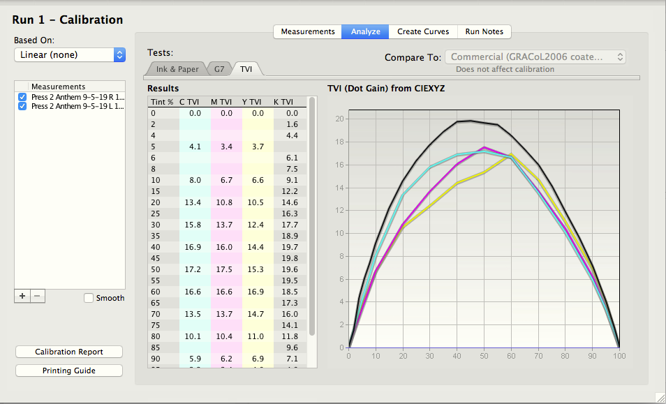

Could you post pics of the dot gain/tone curves for each of the process colors? Why O and G? What ink are you using - i.e. are you using PMS Orange and Green? Did you just ask your ink supplier for the ink hues that you're thinking of using? What screening are you using?
