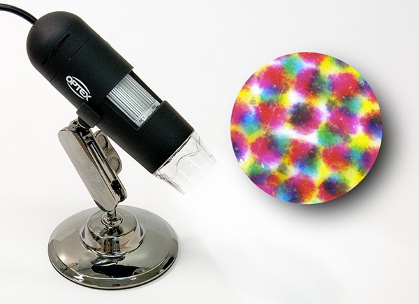

Adding to Steve's post - ideally you will have a microscope that can take photos like this one:
They are inexpensive - usually much less than $100 on Amazon.
You can use it to compare the appearance of the dots on the plate against the dots on the press sheet at corresponding tone values. They should appear very similar. The microscopic view of the dots on the press sheet will also tell you a great deal about the press condition. E.g. slur, doubling, over emulsification etc.

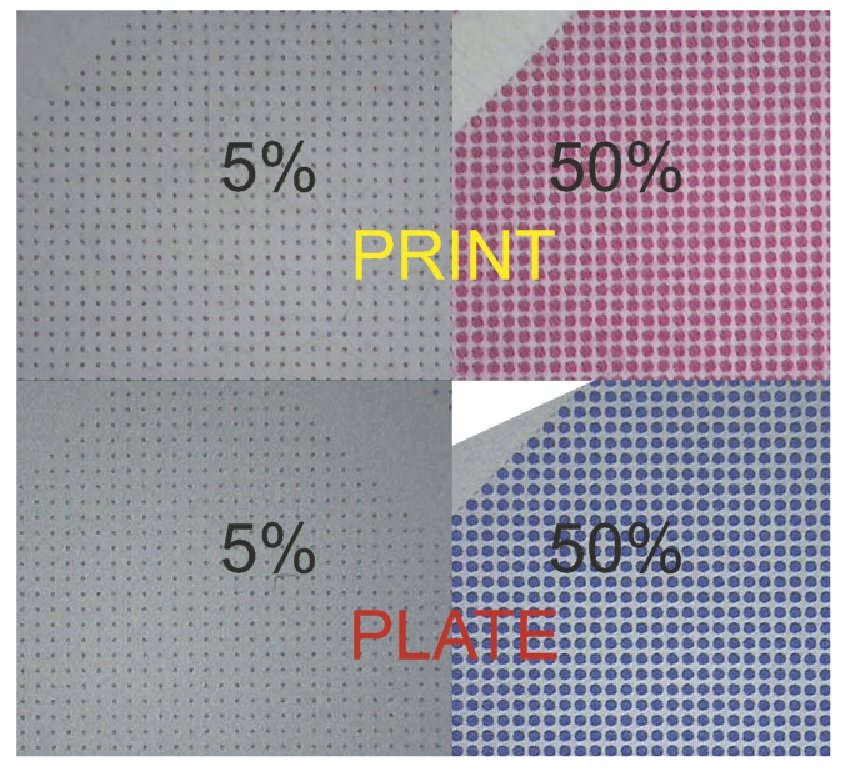

attaching print and plate using the scope. we have xrite exact 2 to read the tvi and the platereader for the plate. please comment
Maks,
The photo looks correct for percent size area coverage.
Round dot shape does NOT touch adjacent dots at 50% but at about ~68%.
So, double check you spectro-densitometer settings and measurement that says your 5% is measuring 14%.
I would trust the plate reader dot size area measurement more (because it's counting pixels) than the spectro-densitometer which is estimating size based on light absorption calculations, either Murray-Davies N=1 or Yule-Nelson N>1.
Also, in your photo, I assume your plate emulsion coating image color is blue and that is not cyan ink?

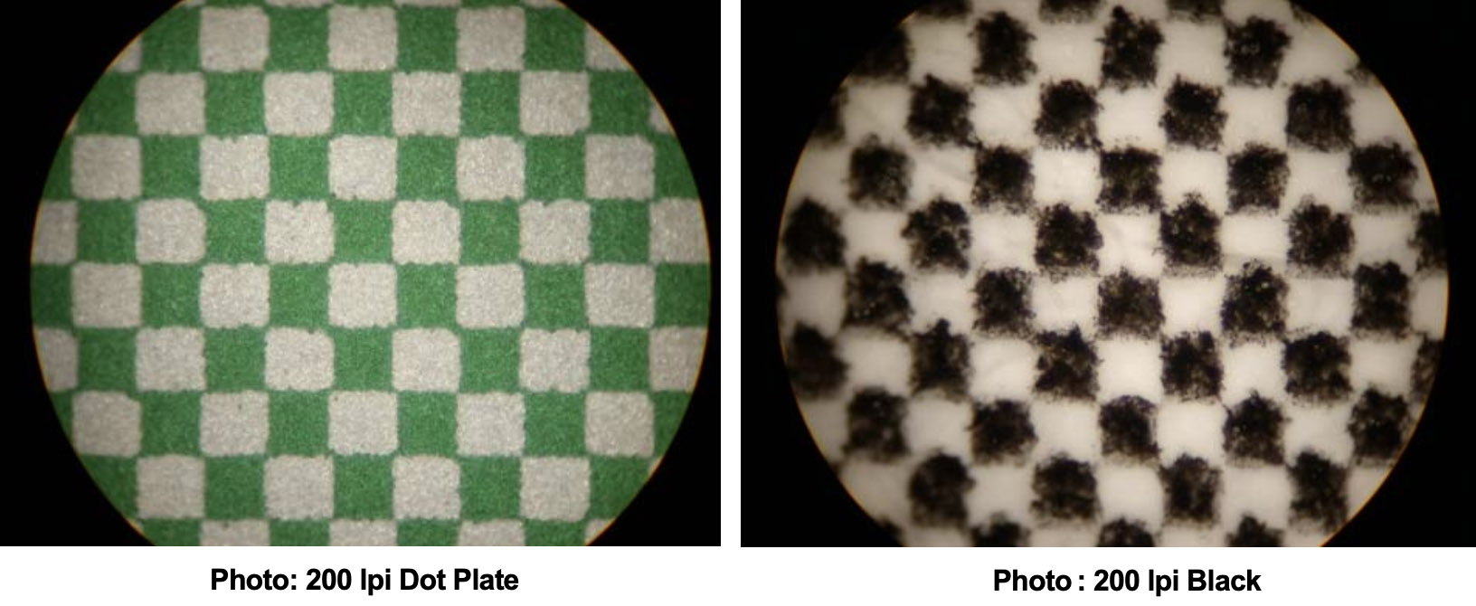

One of the reasons that the microscope can be a very valuable tool is that it can reveal problems that can otherwise be missed.
For example the dot doubling in the black in this plate/print comparison:
BTW did you rotate the images that you posted so that they appear to have the same screen angle?
