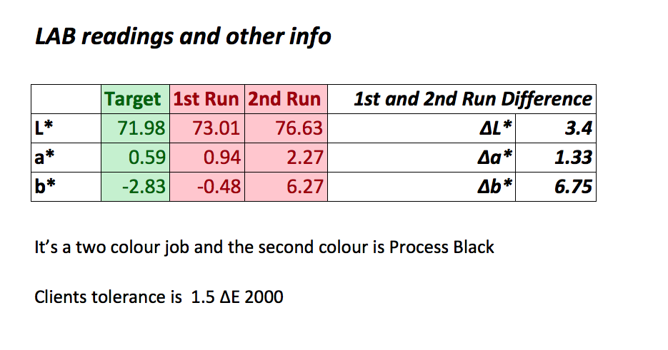

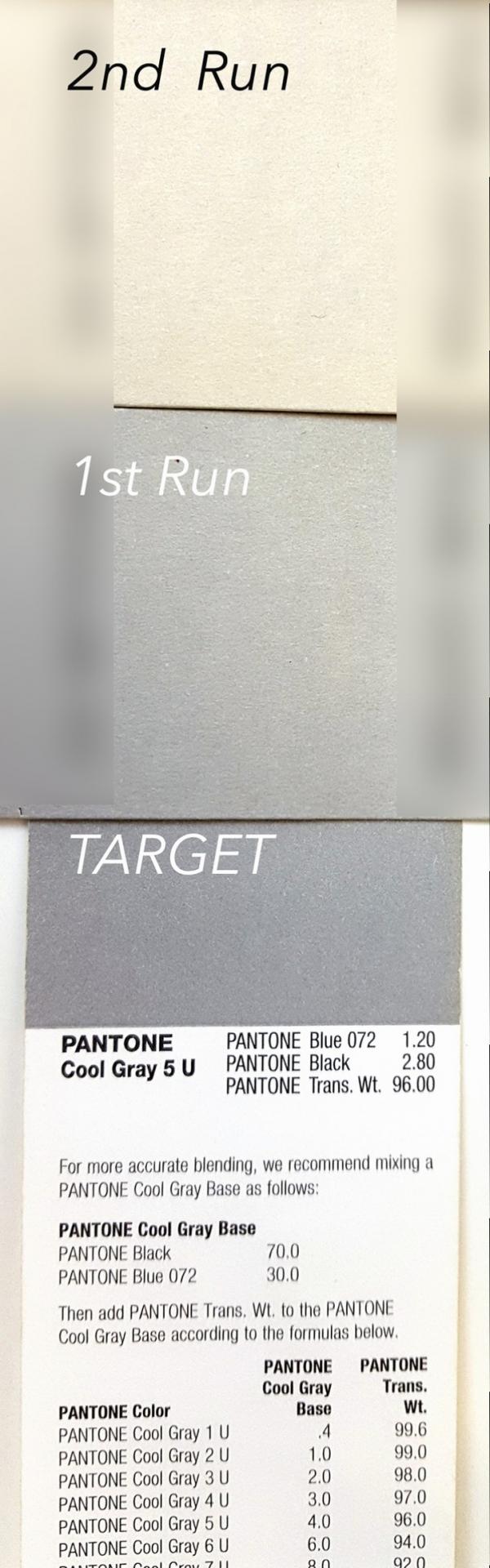

I really need your help. Our sister company has trouble with an offset job. The Cool Grey 5U looks OK when it's printed but after just a few weeks it fades.
Attached is a photo of the target, the first print run and the second print run. You'll see the first run is a little out but second is way off. I've had to blur out the clients details. The second photo has the LAB readings and some other info.

I will ask them for the PressSign reports so you can see the dates of the runs. At the time of printing, both 1st and 2nd run looked like a good match for Cool Grey 5U. They should have both had a delta E of less than 1.5 when the job was in finishing. Today Run 1 looks ok (ish) and Run 2 looks closer to Pantone 7535 U than it does to Cool Grey 5 U.
I'll get you more information when I have it .... Thanks for the article!

Irrelevant ---- Quoting L.a.B. values !!!!
Regards, Alois

Chemical Fading - Check the following 1) pH of the paper , Coated/Uncoated 2) pH of the Fountain Solution 3) Moisture Content of the Substrates

"Quoting L.a.B. values !!!!" - sorry - just wanted to communicate exactly how far the colour had moved and in which direction.

Most likely, your ink supplier is tipping that spot color with something other than the dastardly pAntone formula to give an acceptable match on the particular paper stock you are using. If truly it is the pigments of the pMS book formula, black and 072 blue, you should know these 'exact' pigments are lightfast even in the relatively low percentages contained in a color like CG#5. If the ink supplier is incorporating any other pigment to accommodate a good match, this COULD BE your problem. For instance, if the ink supplier used Alkali Blue G.S. as the blue portion, the problem is solve. Tell them to use Victoria Blue or find another supplier. It the inky also tipped the match with a fugitive pigment (could be any number of types), this could be your problem.
Secondly, it could be the substrate. Give adequate sample of your job stock, along with "2" other random samples of a similar offset paper, with the same grade, basis wt., (make sure to indicate cover or text) at approximately the same brightness and whiteness level as your job stock also. You may have to ask for paper samples from paper vendor, but I would recommend not to get him involved in the analysis and evaluation. Ok, once you have all 3 stocks, submit them to your ink guy and have him proof the CG#5 to proper shade density. Then have the inky, proof the same "VOLUME" or "WEIGHT" of ink on the other 2 alternate stocks. Don't worry about shade variation on the other 2 stocks. Just that the same IFT is laid down. Have your inky measure L*a*b values on his spectrophotometer freshly printed and then 24 hours later after drying has occurred. Tell him to keep going; he needs to run all lab proofed in a fade-o-meter (usually an Atlas brand), for 24-48-72 hours. Then after 72 hours read L*a*b values on each patch of the time intervals. So that would make for a total of 15 separate values. Not finished> Also do the same to each virgin paper stock. As is, 24-48-72 for a total 12 readings for paper only. So at the end of the evaluation you will have 27 total L*a*b values for the subjects aforementioned.
