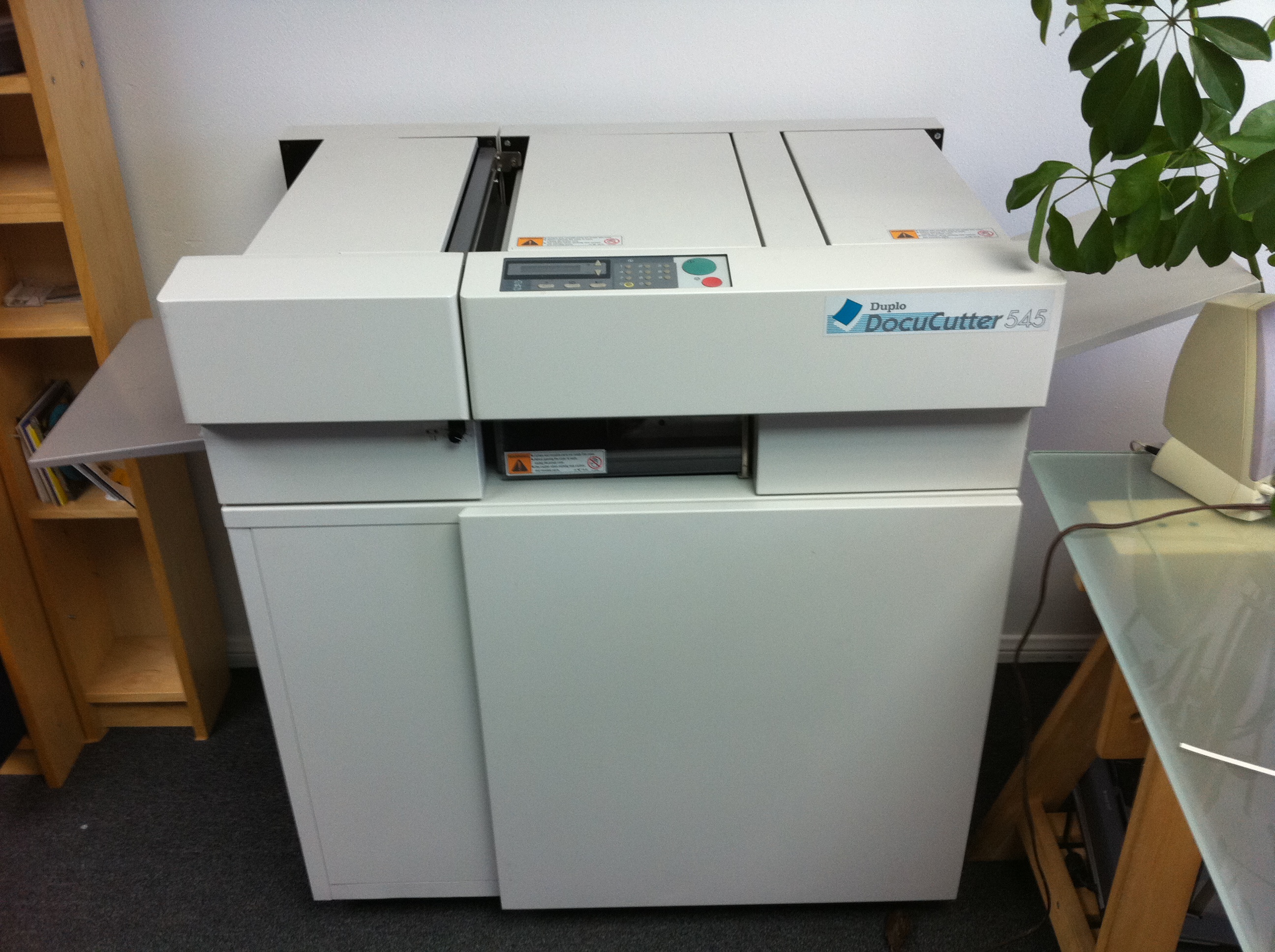

Hi RafalWM,
I have a Duplo DocuCutter 545 for sale. Overall I've been really happy with it. I've used it primarily for a one application: On-Demand Greeting Cards that customers design and order through our website. I use 80lb glossy stock and it works great. I have also used it for Business Cards but much less frequently.
Anyways, I'm going out of the printing business and am looking to sell it. If you're interested or want more info in general, let me know.
