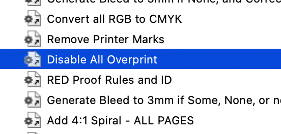

We have an action created to remove all overprints. It was here when I was hired, so don't ask me how it was created.
