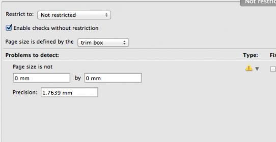

The check has a tolerance which you can configure (it's the 'precision value'. The reason its needed is because not all applications describe page sizes exactly, there are normally some rounding issues that need to be taken into account.
You can reduce that tolerance if you wish to make the check scricter.

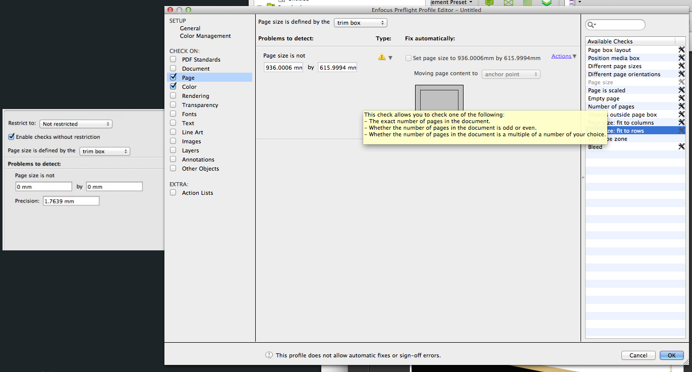

This is how page size appear on my device

Ahh you have an older version that does not have the tolerance in the Preflight Report.
You can still get the same functionality by using an Action List to get the same functionality. You can then add that Action List to your preflight profile.
