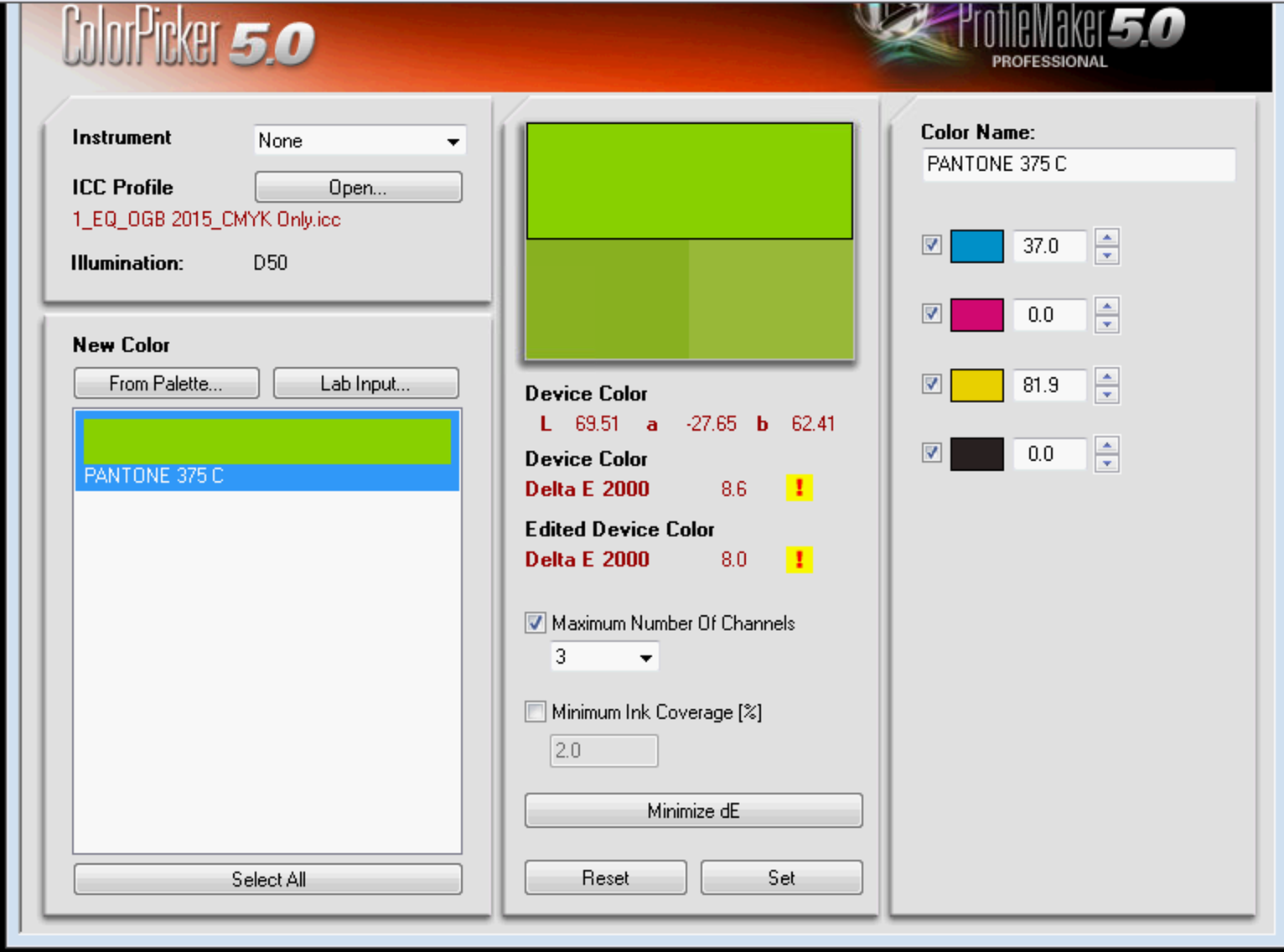

ColorPicker from the old Greytag ProfileMaker suite can do exactly what you're looking for. I think that you can still download it from the x-rite website, and ColorPicker may run without a license, but don't quote me on that.
You load the icc profile that you want to test against (i.e. a custom press profile, or FOGRA in your case), load the Pantone Library as a .txt file (or manually input L*a*b* values), and the software will display the dE and the resulting CMYK when converted through the LUT (Look up table). You can also control the number of channels for the conversion, in case you want to limit it to a 2 or 3 color build. The minimize dE function will usually achieve a slightly lower dE as it bypasses the error of LUT interpolation.
Most higher end color management software can do this is as well. As Gord mentioned, ColorThink, ColorLogic (Basiccolor), Esko ColorPilot. However, none of them do it in as user friendly a manner as ColorPicker. Being an old software, it won't use the latest CMM for conversions, but should be fine for your purposes.
