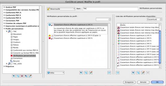

PerfX Image X is very nice but if you want to try with Acrobat 9, it seems to be possible. I made a preflight profile using what is called a "vérification personnalisée" in my french version of Acrobat (maybe "custom checks" in english). I choosed to add three times the same action but with different settings (245, 300 and 340% of TAC, for instance). The first one will trigger an information, the second a warning and the third an error. Then, I made a droplet with this profile. You only have to drop your file on the droplet and you receive a report with all the information you need. It's not fast but it works…
Sorry for the screen capture in french, but I don't have an english version.
